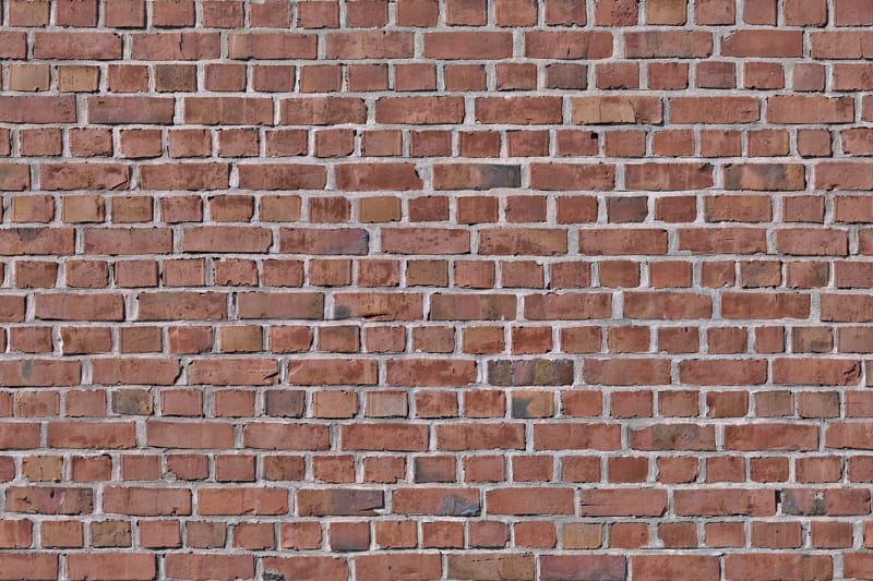

  6. rossmosh
    rossmosh Active Member
    687
    192
    43
    Oct 9, 2014
    New Jersey
    [​IMG]

    You think Acrylic is going to sit perfectly flat on this brick?
  15. DerbyCitySignGuy
    DerbyCitySignGuy Very Active Member
    1,033
    296
    83
    Dec 12, 2013
    Kentucky
    Is that the only type of brick wall that exists?
    You don't own a level?
    [Edit: I'd bet dollars to donuts it's going on a flat brick wall, probably in a school or university.]
    [Edit 2: Will stand offs look better? Yes. Is it the only solution, or even the most cost effective solution? No.]
