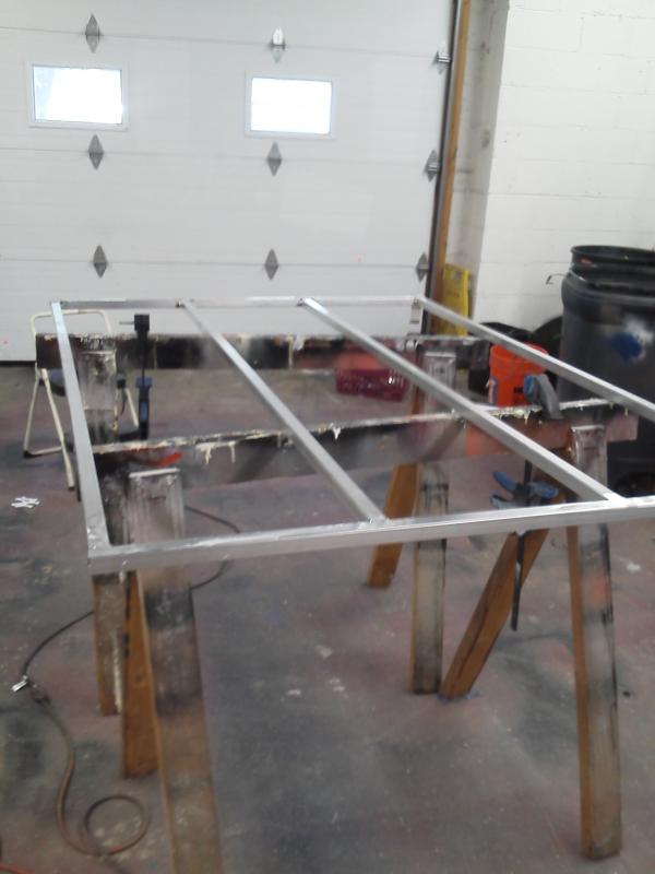

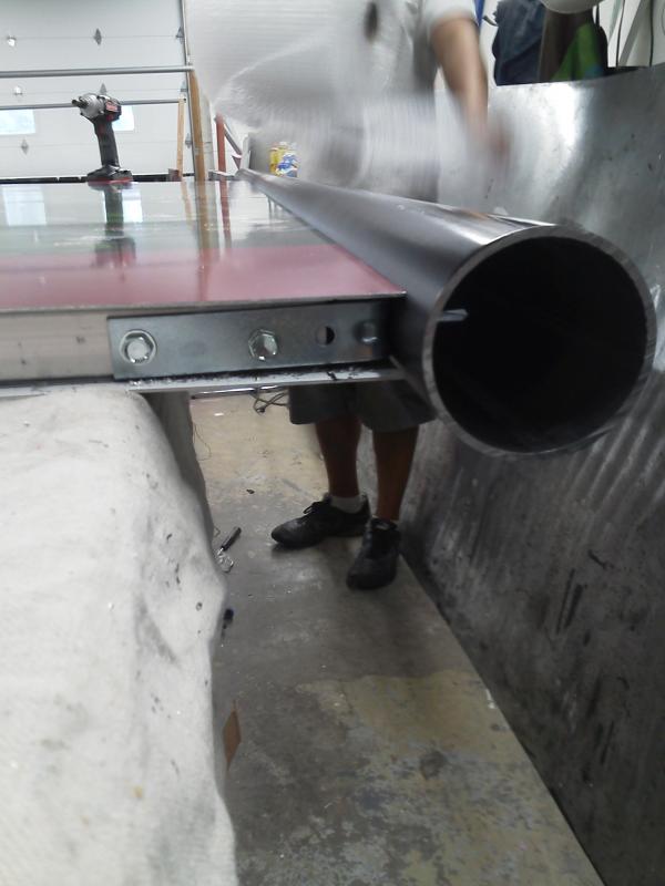

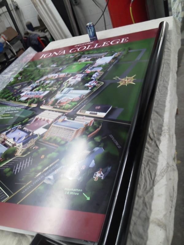

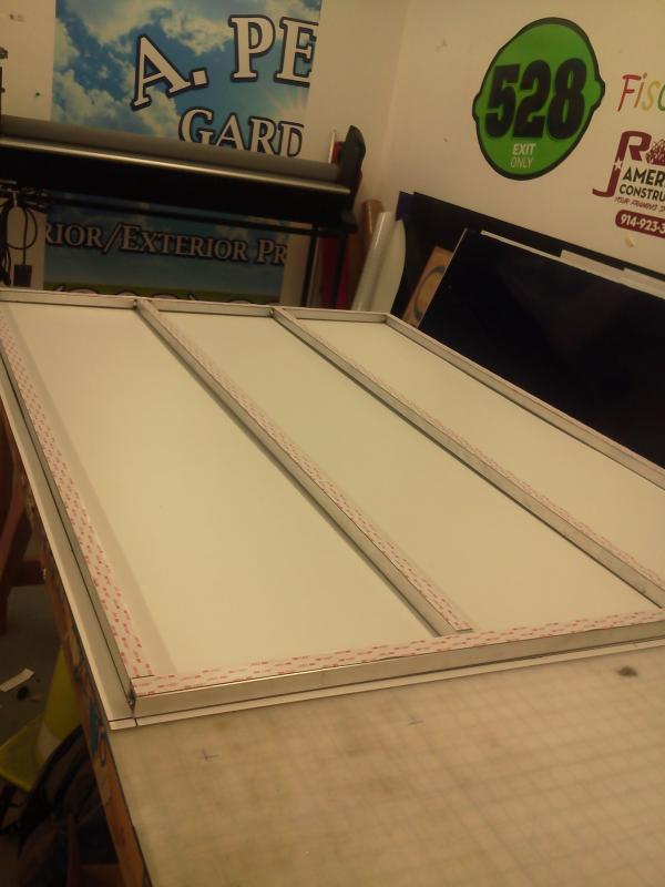

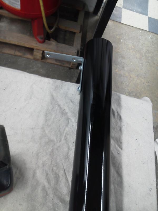

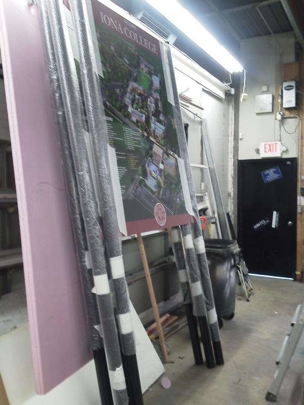

Just figured I'd post an update on these as they are out the door tomorrow morning.
Made frames that were short of the panels themselves so they would be hidden and there would room for fastener heads to be hidden. Thought they came out pretty slick.
Pictures:

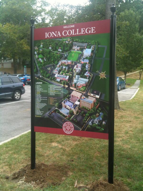

Install was yesterday. Everything went well accept for one site. I've never seen soil like this....it was like drilling through a rock. Power auger was just sitting on top of the soil....luckily they had a backhoe on site with a narrow shovel and excevated a pit for that one. Other than that went like butter. 2 guys, 5 signs, 10 holes, 6 hours with lunch break.
