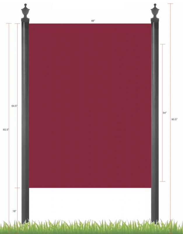

    We're making 1" thick panels that are 64" tall 48" wide. These were originally to be mounted on square posts without caps.
    Got thrown a curve ball this morning. Signs need to be mounted on 3" round posts with attached finnials. Originally thought to just use the round sign comp kit but they are 3 1/4" round and the finnials I can only find in 3"
    So how would you attach these. The only thing I can think of is running a fastener from the outside of the post into the side of the panel. But even then I'm not crazy about a fastener head on the outside of the post even though it will be painted.

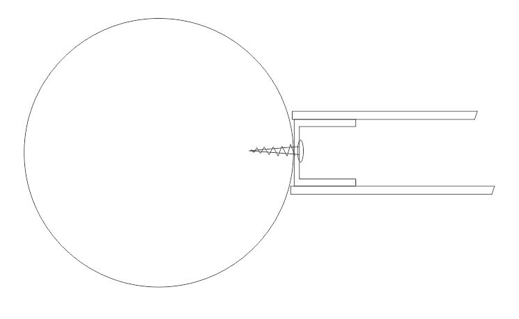

    3/4" U-channel, and 2 1/8" panels:

    Liking this idea. But how do you suggest attaching the .125 faces to the u-channel?

    VHB tape and/or countersunk screws.

  12. J Hill Designs
    15,549
    15
    Sep 24, 2004
    yes. 2) 1/8" panels to have a finish depth of the specced out 1"

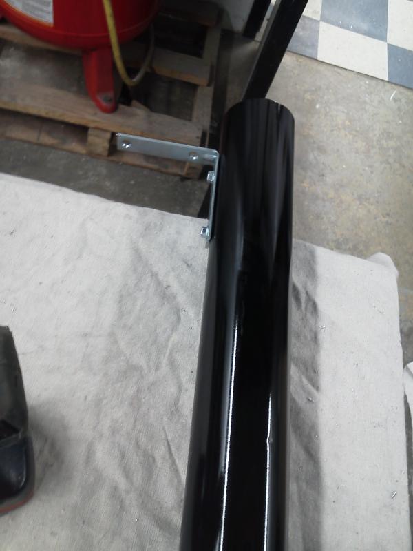

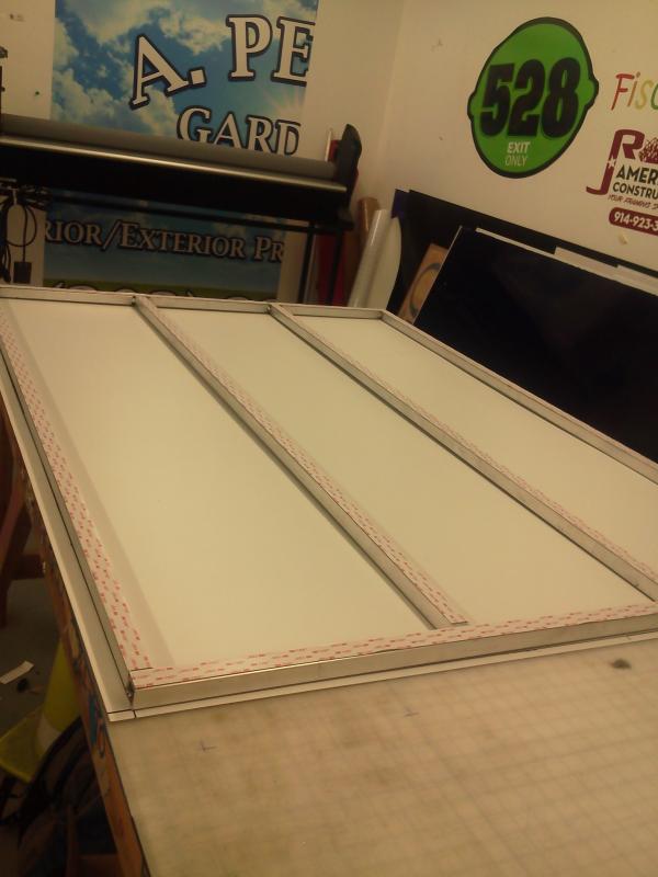

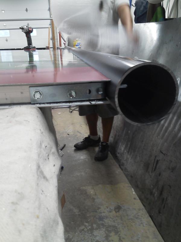

  19. Signsforwhile
    Signsforwhile Very Active Member
    1,401
    36
    Feb 17, 2006
    New York

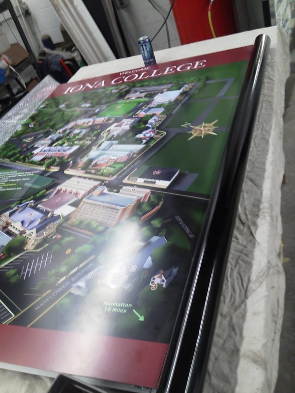

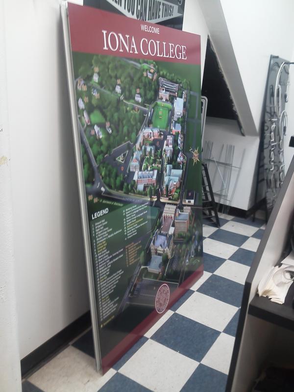

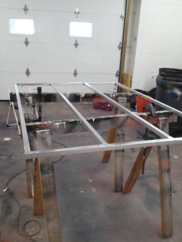

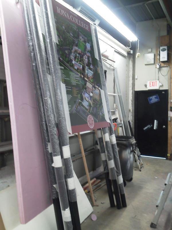

    Just figured I'd post an update on these as they are out the door tomorrow morning.
    Made frames that were short of the panels themselves so they would be hidden and there would room for fastener heads to be hidden. Thought they came out pretty slick.
    Pictures:

    Very clean - nice job!!
