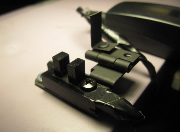

Let's use common sense here...
It is a sensor, it is either opened or closed at any given time. It has 2 wires going to it. Follow the wires to the Mainboard to ensure they are not broken/cut and are indeed plugged in to the correct bus connection. 2 wires and essentially a switch that is either on or off... Option 1: Replace the sensor (what you should do)... Option 2: Unplug the wires (connector) from sensor and use a jumper (small piece of wire) as needed (or use an On/Off switch to open and close the circuit) as needed...
Give a person a fish and they eat for a day, Teach a person to fish and they eat for a lifetime...
artbot
or hot wire it outside of your printer. that way you can pause your print, delicately smooth out a wrinkle, or repostion the media without your printer knowing it and wanting to remeasure. i can't stand a printer with a mind of it's own.
