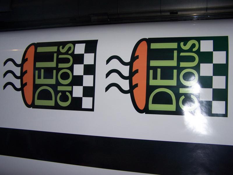

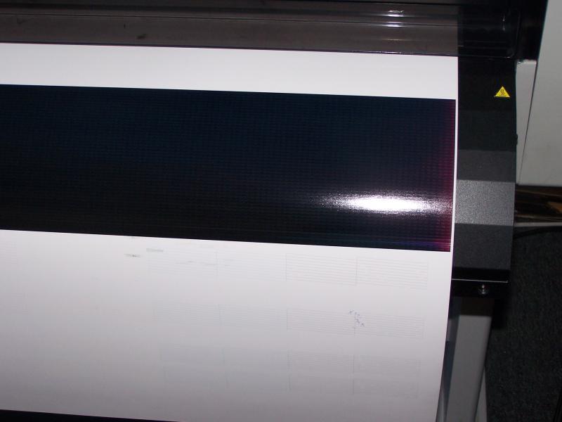

Have you ever seen this issue before? (attached pictures)
randya
Maybe,
The black looks more electrical.
As it is near the capping station, looks like it could be the cable to the head or head board cable is binding causing misfiring.
Harder to tell on the other pic.
signfx
It is weird!
The further distance the head travels from it's station the better it prints.
This problem is worst with black color. It can't print any shades of grays either.
This happened exactly to my Mutoh VJ 1604. The magenta color print better as it travels further from the station. Initially diagnosed as ink starvation. I cleaned the heads, flushed the heads, change all new dampers, check the tubes, cables... everything and didn't resolve the problem. So lastly spend $$$ to change a new DX5 head and it prints perfects ever since. So it might be the print head problem.
signfx
Thanks for the info.
I still have this problem and no one seems to know what is wrong with my machine.
The interesting new development is that if I let the printer sit for a few days It will print a small job just fine!!! but if I continued printing it will go nuts!!
You probably can understand the frustration by having done all those things to yours....
I think I will finally get a new head for it to see if that will put an end to this.
Once again I appreciate your input.
randya
This could be a component (even the head) that heats up over time.
Even a cable with a connection issue.
Unfortunately if it is a component on a board, it could be very difficult to track down.
Keep a log and see if you can make it happen on purpose.
See what it takes to make it happen and it may be easier to find the source.
In your previous photos, irratic printing at the beginning, typically is a cable or cable binding.
Once the 'pressure' is released it prints fine.
