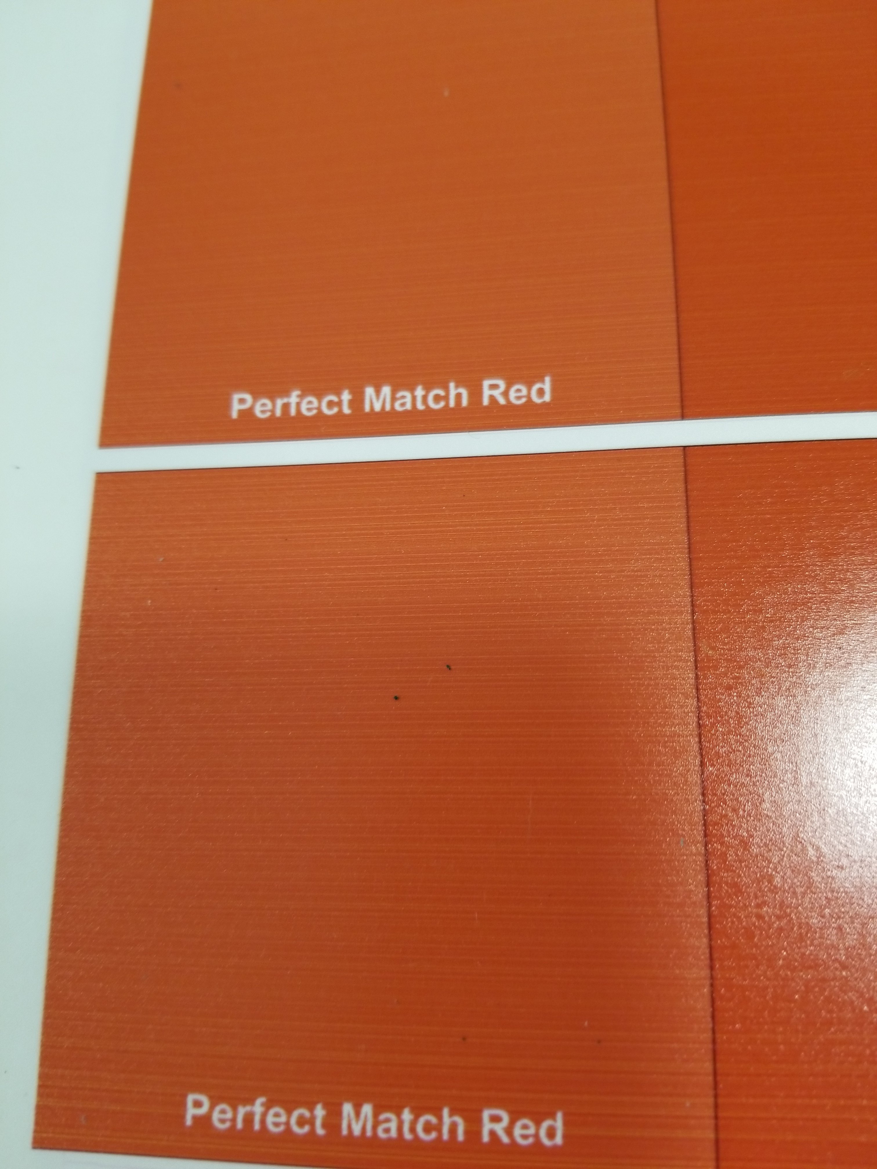

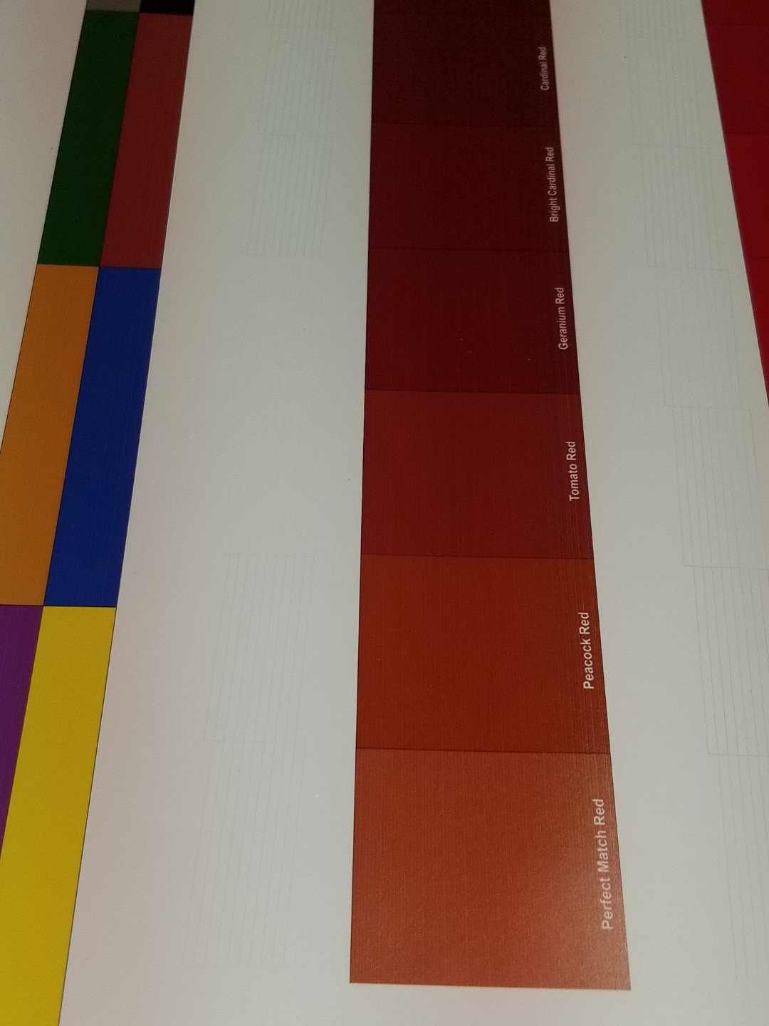

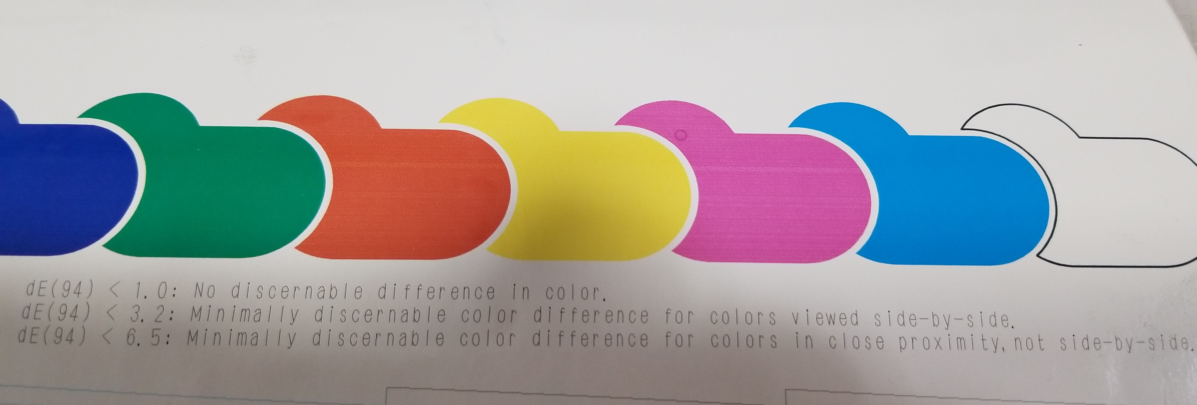

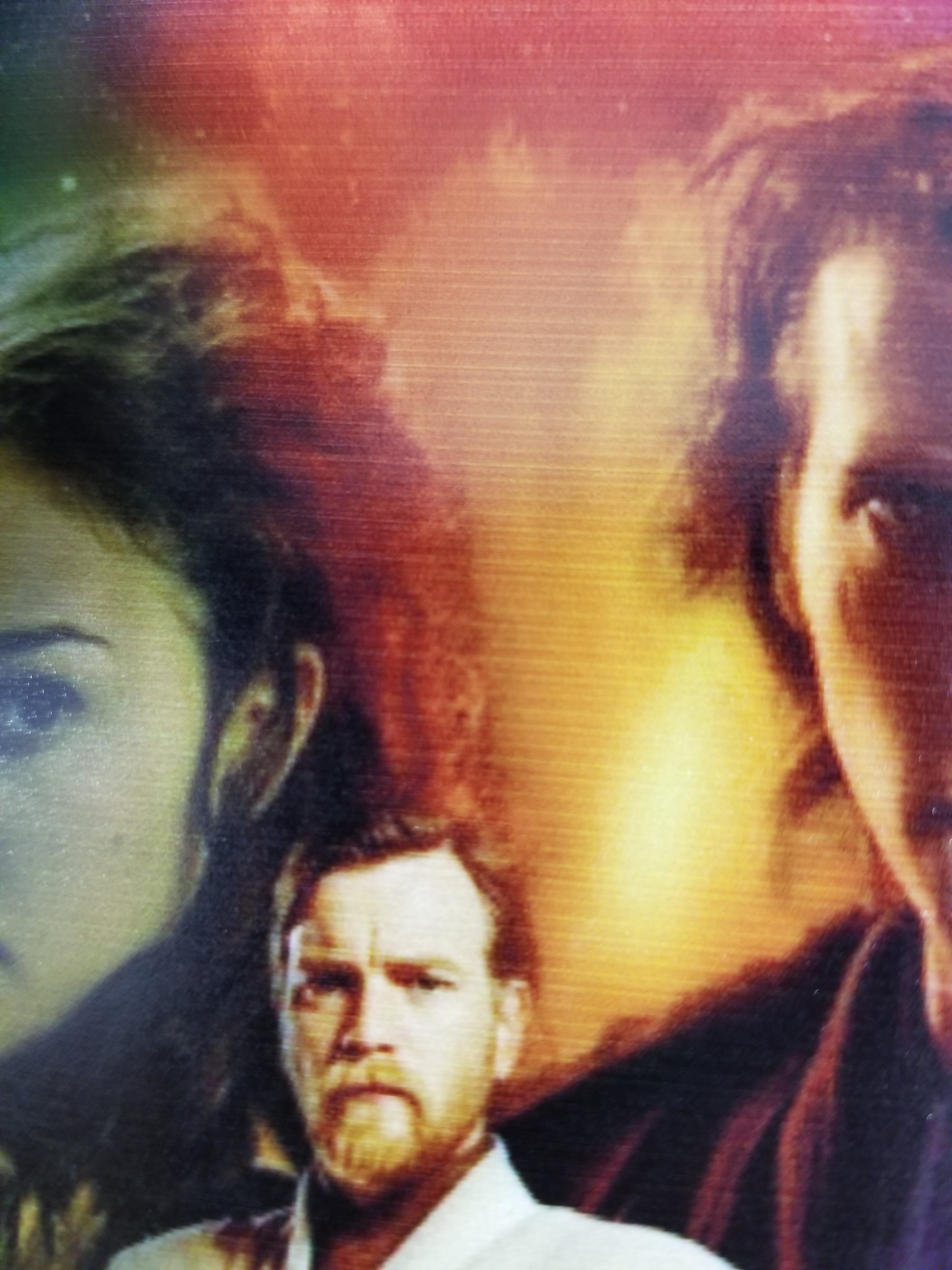

I have replaced the cap and wiper in the service station, replaced the magenta damper and still get streaks. Attached close ups of prints, what gives

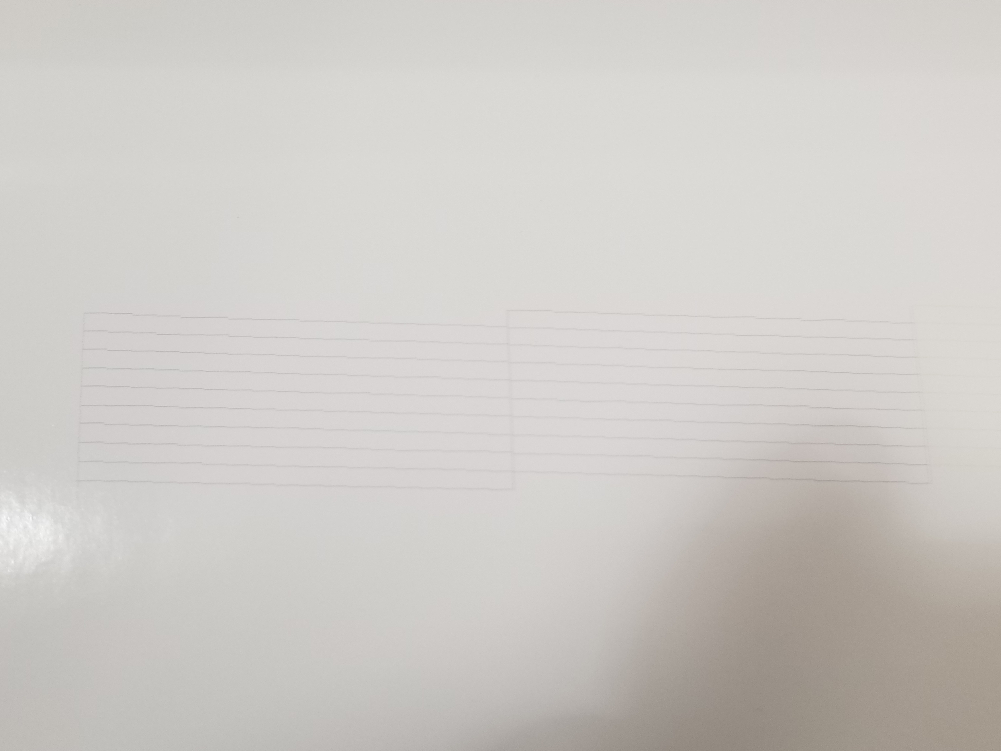

Streaks are clearly visible in the test, nozzles are flawless. What then?

Unfortunately whenever I see a perfect nozzle check but there are still streaks in the actual prints it's a failing print head. Looks like your magenta is the problem for sure. How old is the head?

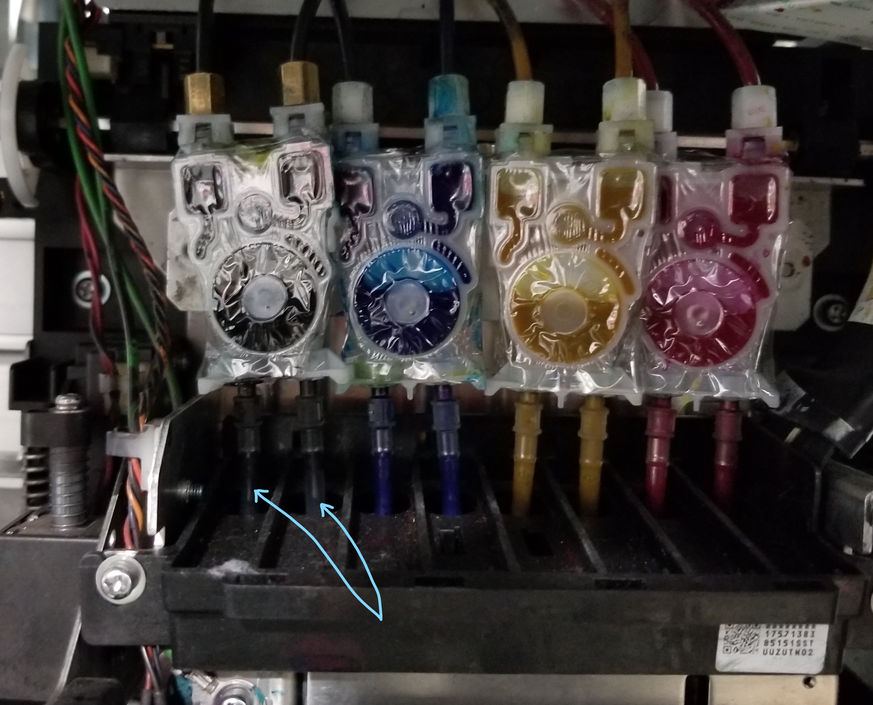

I have the print head in the shopping cart. Can I also get 2 connector tubes, see photo?
Thanks
I can get them from Mutoh but only as a set of 8 and it's around $133 no joke. You can try using 2mm ink line but I can't guarantee that will work long term. I have done it in a pinch as a temporary fix and it worked.
azmaestro
I did exactly the same mod a month ago, you can probably notice in the photo, the second one from the left and it is still good. I'll order the head anyway.
