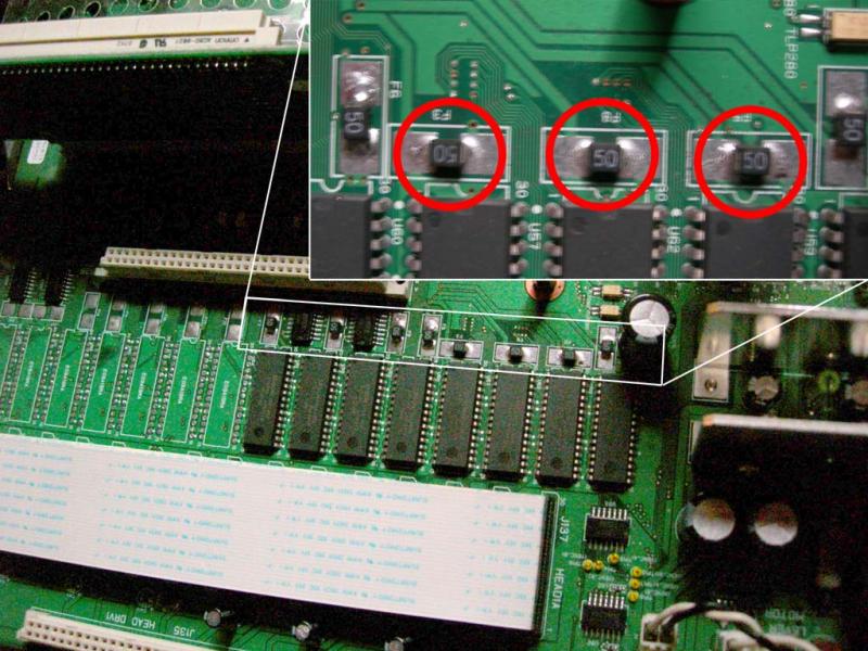

I own a Mutoh Rockhopper II, and since the thursday of the pass week i had an error, specifically Error 103 Fuse 2.
I mentioned the problem to my service tech, and they told me is a problem of one fuse in the motherboard, those who are black, small, with a number 50 in the top (look the pic). The technician, told me that are fuses of 2 amp, and are located near the connections of the printer-heads. With a tester I could check which of these fuses were gone.
I founded 2 of theses fuses that weren't working (chekecd with a tester), so I bought 2 fuses of these kind, and changed the olds for the new ones.
NOW, after welding the fuses to the motherboard, check that are ok, and reconstructed the machine, I turn on the machine and happen this:
1) the plotter hangs in boot
2) all the leds of the control panel are blinking
3) i can't turn off the plotter, the only way is unplug the power.
I'm waiting the verdict of the service tech, but these guy take their time...
What i did wrong? the fuses are well welded, and i didn't touch anything in the motherboard.
Could be a printhead burned that cause some kind of short circuit?
A problem with the head board?
The motherboard is gone?
Please HELP!!

It may be difficutl to diagnose what caused the fuses to burn in the first place.
That may still be the cause of your issues.

i would check for any solder bridges. If you replaced those fuses and welded them in with solder.
Also, wash off the solder flux. This stuff will cause an electrical leak too.
