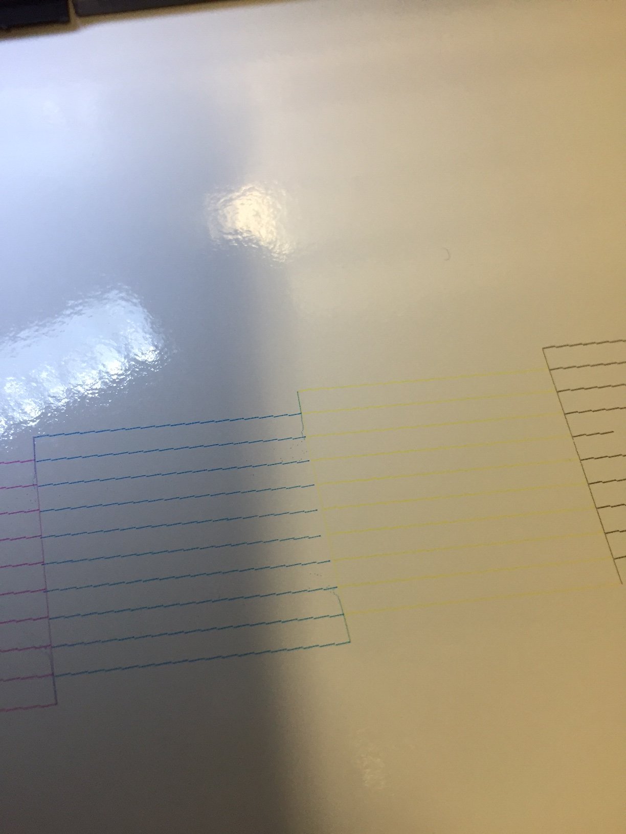

Today I experienced something wrong with my prints, the cyan was all over the place. You could say that it was like a mist of cyan on the vinyl next to the printed area.
I'll post a pick of an adjustment pattern where you can see that it is head nr2 that´s the issue . Let me know what you think I should do. New head maybe?
I´ve tried soaking the heads in the capping station for about half an hour and performed two long cleanings after that. I also made sure that the capping station connected well to the print head and that there are no clogs in the vacuum lines.

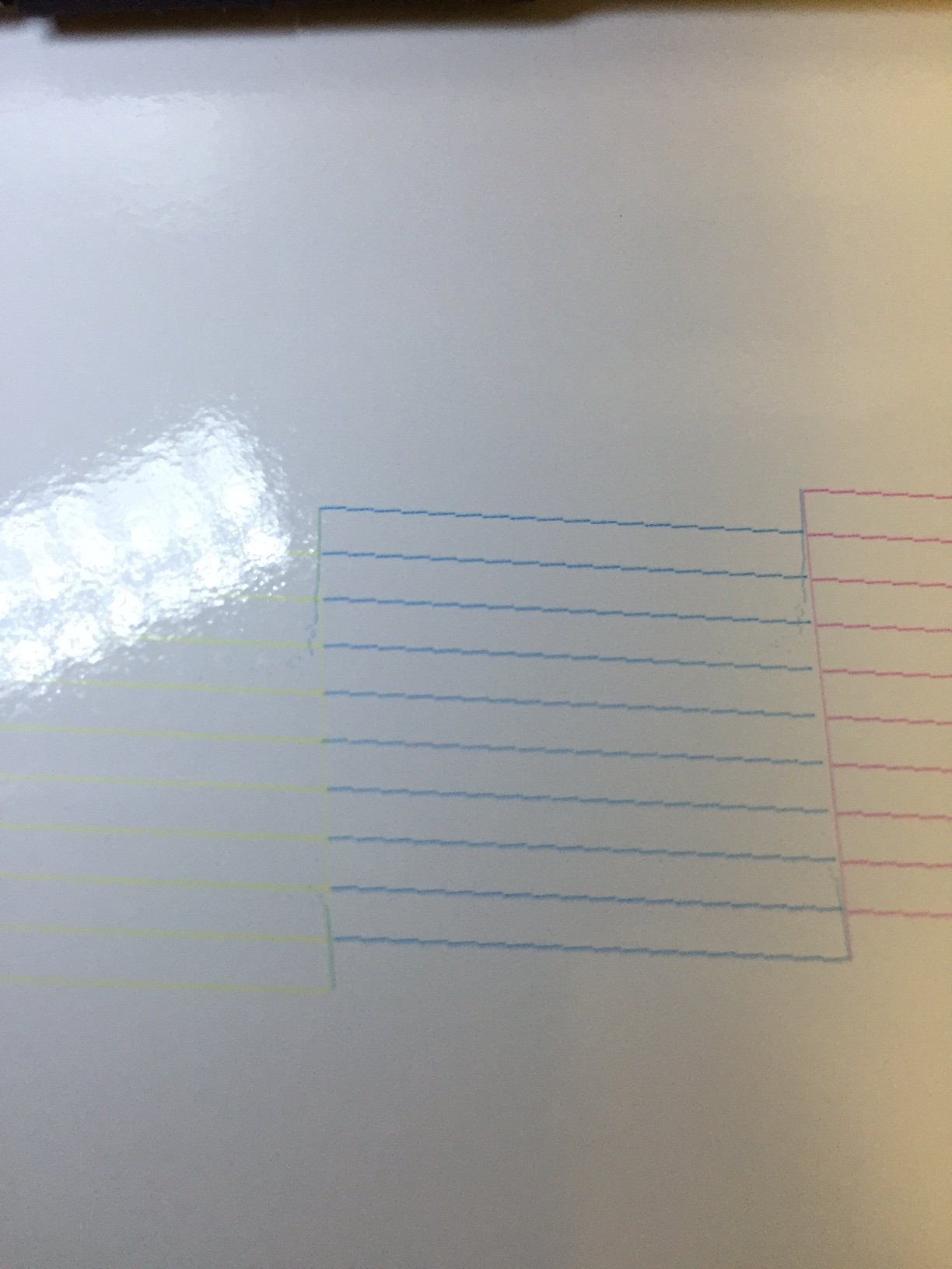

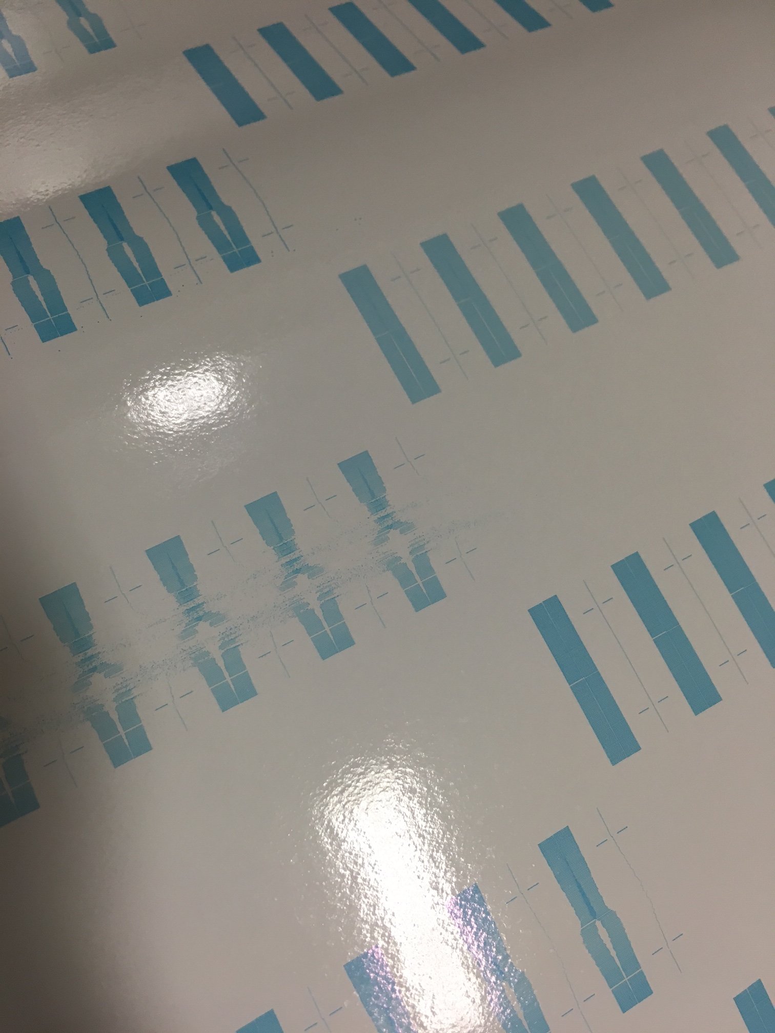

I didn't notice anything suspicious about the cables but I did unplug them and checked them just to be sure.
One thing I´ve noticed however is that the nozzle check looks bad on both heads regarding the cyan. Maybe there isn't a problem with head nr2 since there are issues with cyan on both heads!?

There should be 2 cyan channels per head. Are the cyan channels both bad on one head or all 4 bad on both heads? If it is happening on all 4 cyan channels, I would be concerned that there is either a board damaged or the ink is bad.
lillhannus
Thanks!
I replaced the cyan cartridges yesterday with new ones from another batch. After that I did about 3 small ink charges and a few cleanings. I also printed about 1x1m cyan so I think the new ink should have came through.
This was without results though.
Is there a way to turn off one head so I can confirm if it´s one head or both that is bad?

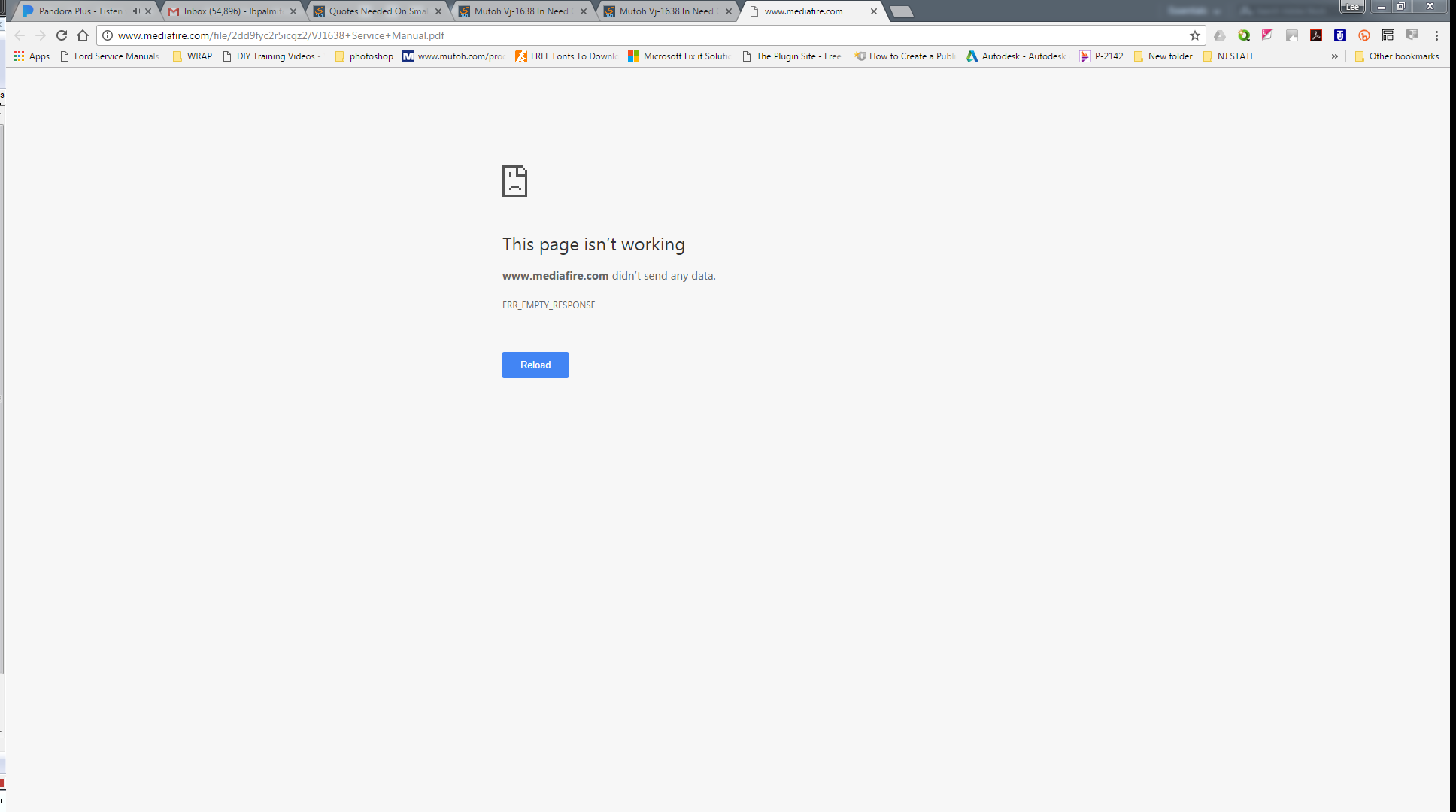

? I do you a favor and you insinuate that I would take the time send you a malicious file?!
lbpalm
- It is the mediafire website which pops up messages for all kinds of dubious links.
Just be careful where you click.
- The first couple times I went there the site (not your file) was blocked by my scanner...
So no, not unless you operate the mediafire site.
C
ColoPrinthead
Guest
Sorry about that I have been using media fire since 2004 and had not seen pop-ups on my end.
lbpalm
no worries.
- Actually, you are right, it was my scanner that popped (up after blocking the site a couple of times).
I think those ads rotate, so if you happen to get a bad one it could be caught.

I´ve tried this without results. I also cleaned the encoder strip.
Today I turned one head off at a time and checked the results and I got the same kind of "overspray" on both heads.
Mutoh tells me it´s likely a head that is failing but I doubt that both heads should fail at the same time.
