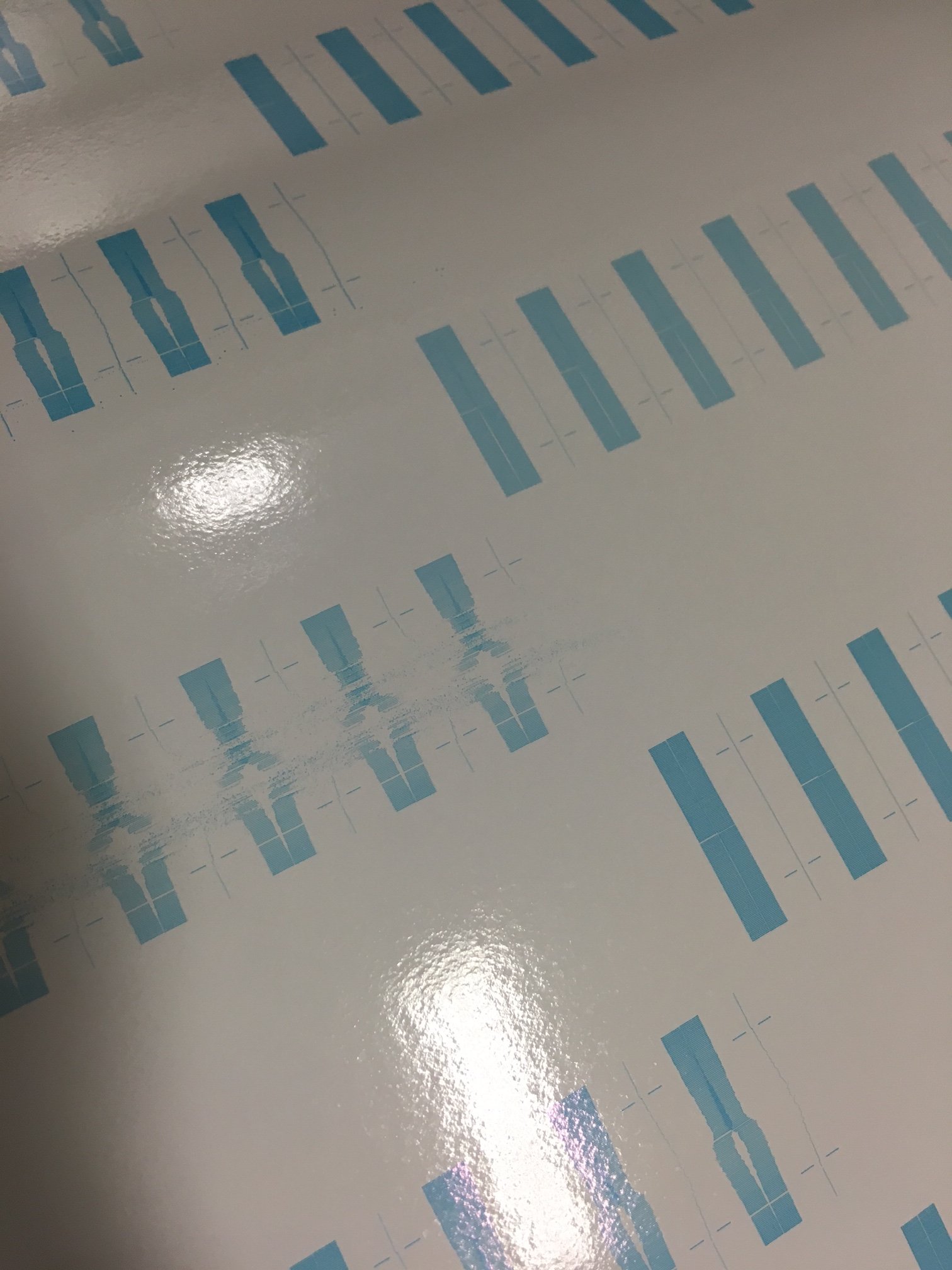

Hi,
Today I experienced something wrong with my prints, the cyan was all over the place. You could say that it was like a mist of cyan on the vinyl next to the printed area.
I'll post a pick of an adjustment pattern where you can see that it is head nr2 that´s the issue . Let me know what you think I should do. New head maybe?
I´ve tried soaking the heads in the capping station for about half an hour and performed two long cleanings after that. I also made sure that the capping station connected well to the print head and that there are no clogs in the vacuum lines.
Have the same problem; my 4the printhead is broken in 1year. Mist in Cyan. I use bulksystem whit UMS ink. Mutoh say "Not home"
