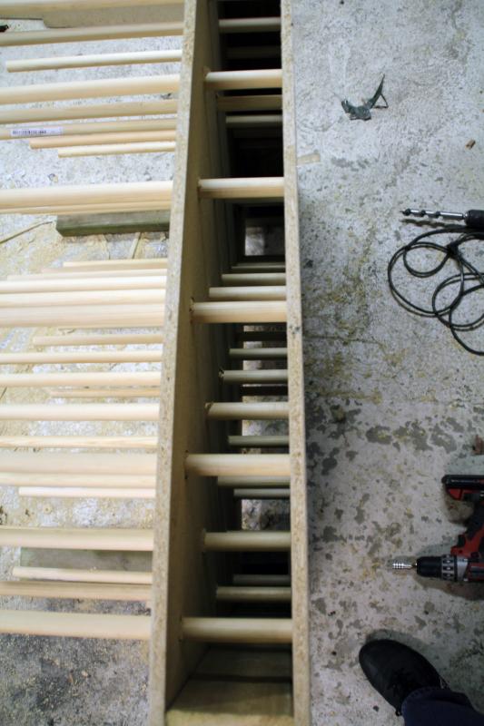

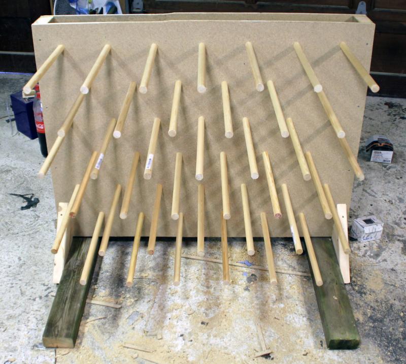

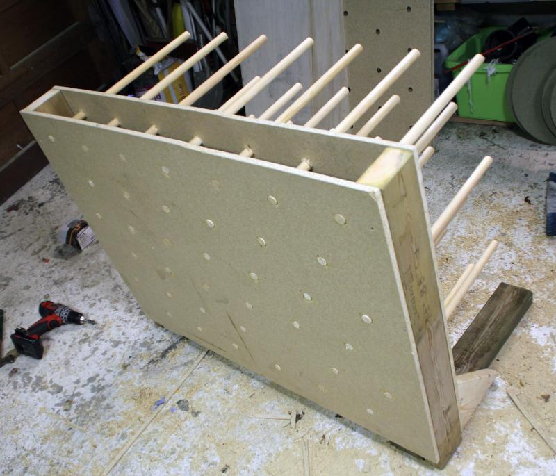

Keeping up with the others. I thought I'd show my basic but functional vinyl racks for my 24" rolls.
Used some particle board sheets and some 2x4" found in the garage, and bought a load of (insert fancy word for broomhandle) material.

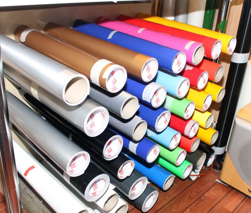

Set about marking and drilling holes, 2 sheets at a time so the holes would line up perfectly. Then assembled them with a 2x4 in between to space them apart. The reason for this is to make the poles stay in place when loaded with heavy vinyl rolls. Even with a full new roll they do not budge at all (lucky with that). It does not come clearly across in the pics, but the racks are angled slightly backwards for added stability. They are also made to size to fit under my worktable, so now I can fit about 70 rolls without taking up any "real estate" in the room.
