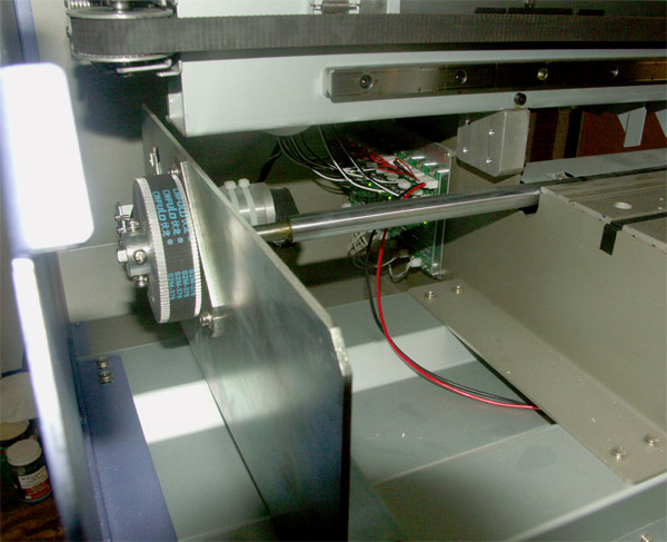

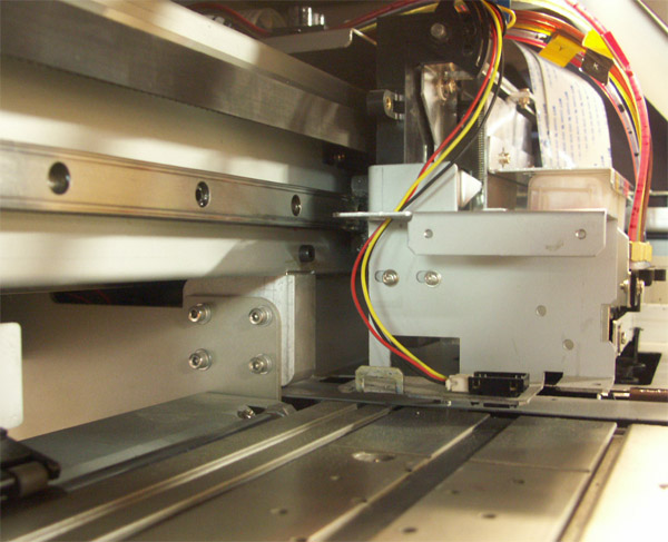

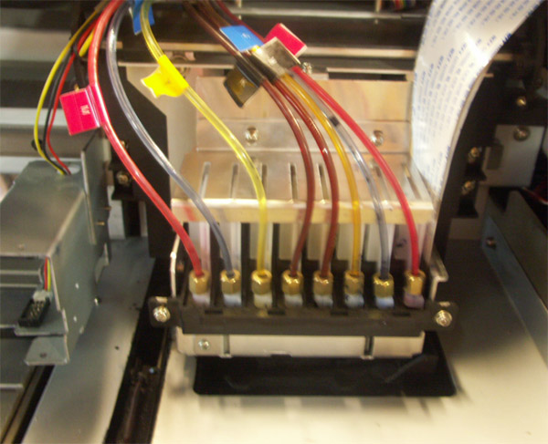

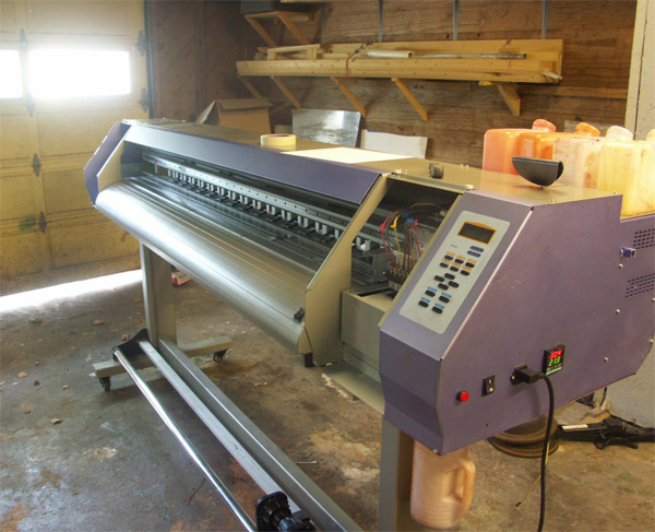

artbot

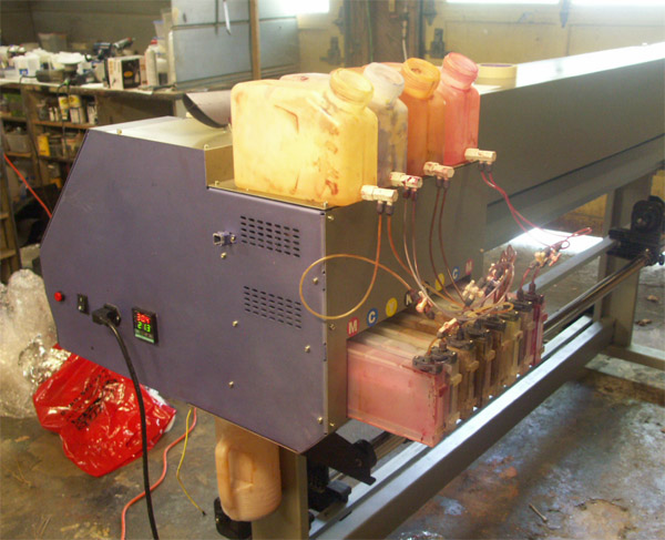

photos
final photographic proof that the chinese builders do not send you a crate full of sawdust.

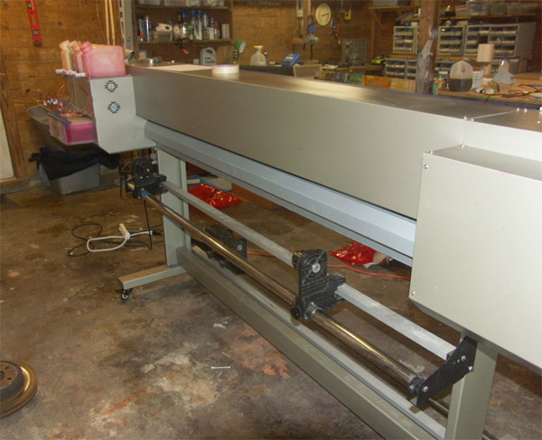

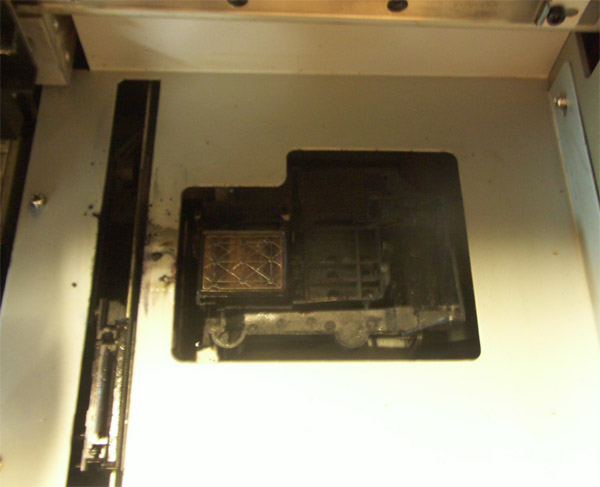

artbot

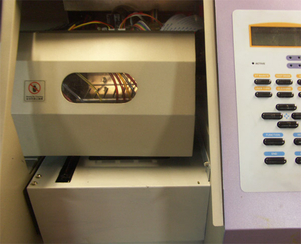

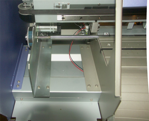

more photos
text text text text

Masseria
Ok, im back from a little vacations sorry for the delay... i'll send as soon as possible to you Rasterlink 5Pro SG trial version so you can test it...
Looks like a jv33 to me, but 100% chinesse building....
and 100% chinesse means...
GOOD LUCK........
jhanson
Heh. That's a Mutoh ValueJet head carriage knockoff.
I doubt the printer firmware is going to be anywhere close to being compatible with the JV33 firmware. Quick question: To make it work, did you have to install a USB dongle and some Chinese controller software?
Also, for those bulk ink cartridges, you can just remove the plastic "lockers" altogether and plumb the lines straight from the bottles to the cartridges. The lockers have an annoying tendency to leak. Keep an eye on the cartridges as well, because when the valves inside get stuck open (they will, eventually!) you're going to have a big puddle of ink on the floor.
Jack Knight1979
that's a good looking machine!!!!
Please let me know who you like that bulk system. I currently use the easyfillpro. It's a garbage unit, but I've gotten passed the awkward shortfalls of the unit and can be productive with it.
I would like to upgrade to this unit at some point.
artbot
i'm sure i'll be selling the CIS. i just need the carts. these carts have a long float inside that pinches the line when floating horizontally. very simple system.
good or bad, this thing is smooth. it has a very light touch, very quiet. my jv3 can be heard from the next room just running the pumps.
only one issue that the owner did warn me about. if the rear power switch is turned off, you have to boot to the service menu. then you are good to go. if that is the only thing i run into, than i'm good.
and just to keep a frame of reference on how "cheesy" this printer is or isn't, i have a one year old, 60", dx5 solvent printer in my garage for $3780.
SightLine
Intersting. Definitley more like a JV33 than a JV3. JV33 style controls and frame, Mutoh carriage, definitley a DX5 head with DX4 style oversize dampers so it's not a valved ink train. Also will want to be sure the wiper is a solvent resistant one. The solvent wipers are usually blue on these. As long as that head is good and you can get a RIP to print to it you are going to love the alignment on that DX5. The RIP is going to be the trick, if one will run it using a JV33 config you will be set. I kind of doubt the dongle-less OEM Rasterlink versions will run though since they probably will not detect the firmware as original Mimaki firmware.

on the wiper, it is set up/purchased as a solvent printer that the guy put dye sub ink in. i'll email him and ask him. i really need to get this thing printing soon. i'm wondering if there's some miracle cleaner to clean up the capping station. ... from what you guys/sightline see... this looks to be a mutoh aftermarket capping station?
SightLine
Cannot tell really. They all use the same captop itself but the station is not like a JV33 one. I should have a picture of the JV33 one in another thread somewhere. Just clean the rubber edge of the captop itself just like you would the JV3 cap tops with some solvent. If it was setup for solvent to begin with you should have no worries and it sounds like they have something in the firmware to make it appear as a Mimaki which is great.
