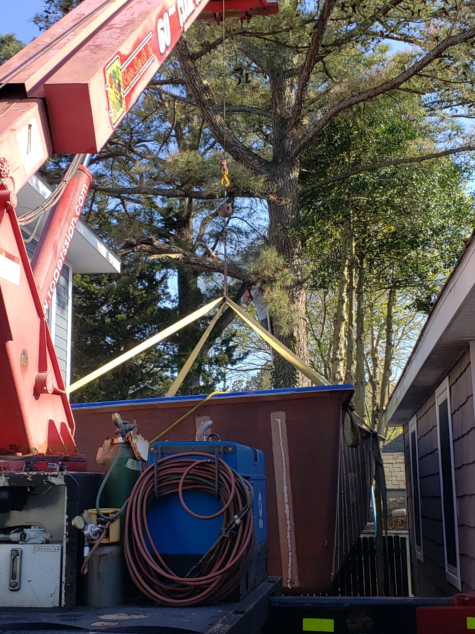

Here is something I wish I'd thought of when we geared out our new bucket truck. If you plan to put a generator or torch tanks on it, 'temporarily' mount them to the back of the truck, not behind the lamp/tool bin immediately behind the cabinet. I have our welder mounted with threaded inserts into the deck, which was great because we could drop the welder if we needed to (if some overzealous state trooper decides to weigh your truck, this will save you a tow bill). But don't put it 'in front' of the main boom, because if you'd like to go to the ground to grab something, and your truck is facing the sign, you will either have to rotate that much more to pass the welder/tanks, or risk hitting the welder and putting a dent in that brand new welder. (ask me how I know)

I have had welders up on the bed rite behind the bulb bin and it takes up so much room moved welder and tanks to the driver side rear works out good its all pretty much in arms length
