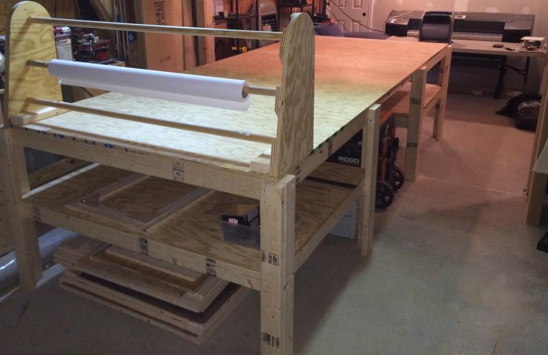

My new work 5x12 work table
Justinglinn
Would most agree that a self healing mat is a great way to go for a table top? I may add a gantry on the sides of the table to create a very low end Rollsroller or Rogueroller.
Please be kind in regard to my very humble setup. I m trying to start of very small in hopes to build something much larger in the future. I concentrate on onsite consultation and deliver/installation in my area.
You may notice my older HP Designjet, she is going to be joined by her much younger friend, a 54 inch Mimaki Print/Cut
Any advice and constructive criticism is most welcome. I would love any and all input to make my little startup the best it can be.

very nice. i went a lonnnnnng time without a cutting mat. now i dont know what i'd do without it. the grid is worth the price alone.

Looks like it weighs more than small steam locomotive. Unless you're planning on holding barn dances on it, the heaviest thing it has to hold is itself. More often than not it's far simpler to get a heavy duty 3x8 or larger banquet table down to your local office supply emporium and screw a larger top onto that. Just as sturdy, lighter, and has the charm of being transportable.
Regardless, the next time you build one, let the top overhang a few inches. Gives you something to which to clamp this or that. And you will want to clamp this or that from time to time.

I wish I thought of clamps in advance! And you are correct it is as heavy as heck! I did build it sectional though. It comes a part in three pieces. I figured it would eventually travel with me to a larger place when my business grows.

I'm good with the heavy. You want the top to be as true to perfectly flat as possible. Another yes on a self healing cutting mat. Get a single piece - you can get mats up to 6 feet wide x custom lengths if you special order but 5x12 is a standard size. It will come rolled, heavy - have to let it lay flat for a few days to get the curl out.
One thing I would have done different - notch the shelves and put those leg uprights inside the top perimeter frame instead of on the outside. When working around the table you will be running into them constantly. That and as Bob mentioned, leave 2 to 3 inches of overhang - in other words make the upper perimeter frame a bit smaller than the actual top by 4 to 6 inches overall. Still very similar build to how I did ours (same size too). I did also add 6 heavy duty (but smallish 3") wheels to ours so we can roll it around which is very very handy at times.

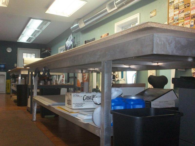

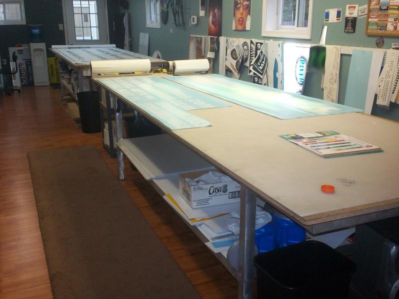

Yes, Definitely an overhang and self healing mat.
These two are ten years old and work well, I wouldn't change them.
4 x 12,
4" overhang.
3.5" x 1/4" angle, 96" in between legs
2' square legs, 2" angle for everything else.
3/4" particle board tops (Two 25" x 145" counter top stock - cheap)
One table has hinged top to raise like a drawing table but I don't use it anymore, just built a big easel.
Not very hard to build with a miter saw and a welder.

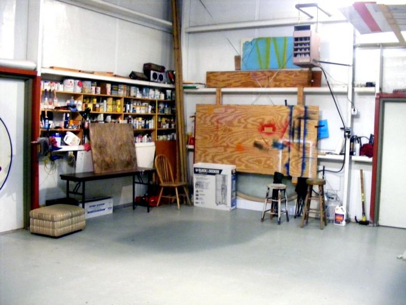

nice table for weeding/applying transfer tape. but being an old "sign painter" i still use an EASEL setup to apply vinyl to sub-straight.
i just find it so much easier to align lettering, art work when its right in front of me....at a 15 degree angle off the wall. i have one in the carport near the vinyl cutter and i have one in the shop. simply a 4 ft X 8 ft 5/8" thick plywood sheet......on a couple of 2 X 4 leaning at about 15 degrees. my main reason for doing this was my bad back. weeding and tapping on a table i can sit on a stool.....applying vinyl to sign material....i do better standing up and having my work right at eye level. did this pan face yesterday. on the easel!!!
you can see the 2 X 4's and under the pan face is a 4 x 8 sheet pf plywood. sorry bout the black part, 8:30 AM sun was hitting car port to cast that shadow in the left upper corner.

not a problem........the one i have in the shop, is hinged on the steel purlin and i have standouts on the back to get that 15 degree angle. i can fold up the standouts and easel is flat against the wall. as in this pic....

Yes - DO account for the final height and do not forget to account for the thickness of a cutting mat when figuring this. We built ours to be about 1/8" shorter than the back table of our laminator. You want a tiny bit of drop in my opinion. Not cool if stuff coming off the laminator catches on the edge of the tables.
