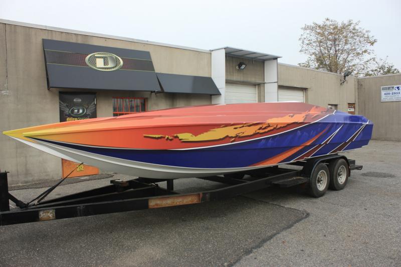

Heres a boat we did two months ago

Perfect example of design on this boat. The front wants to come together at the rub rail as the boat moves inward toward the tip. So don't try and cross the rub rail with graphics up front. This cat here isn't as bad because the front of the boat isn't a tip. So keep that in mind.
Nice wrap BTW.
