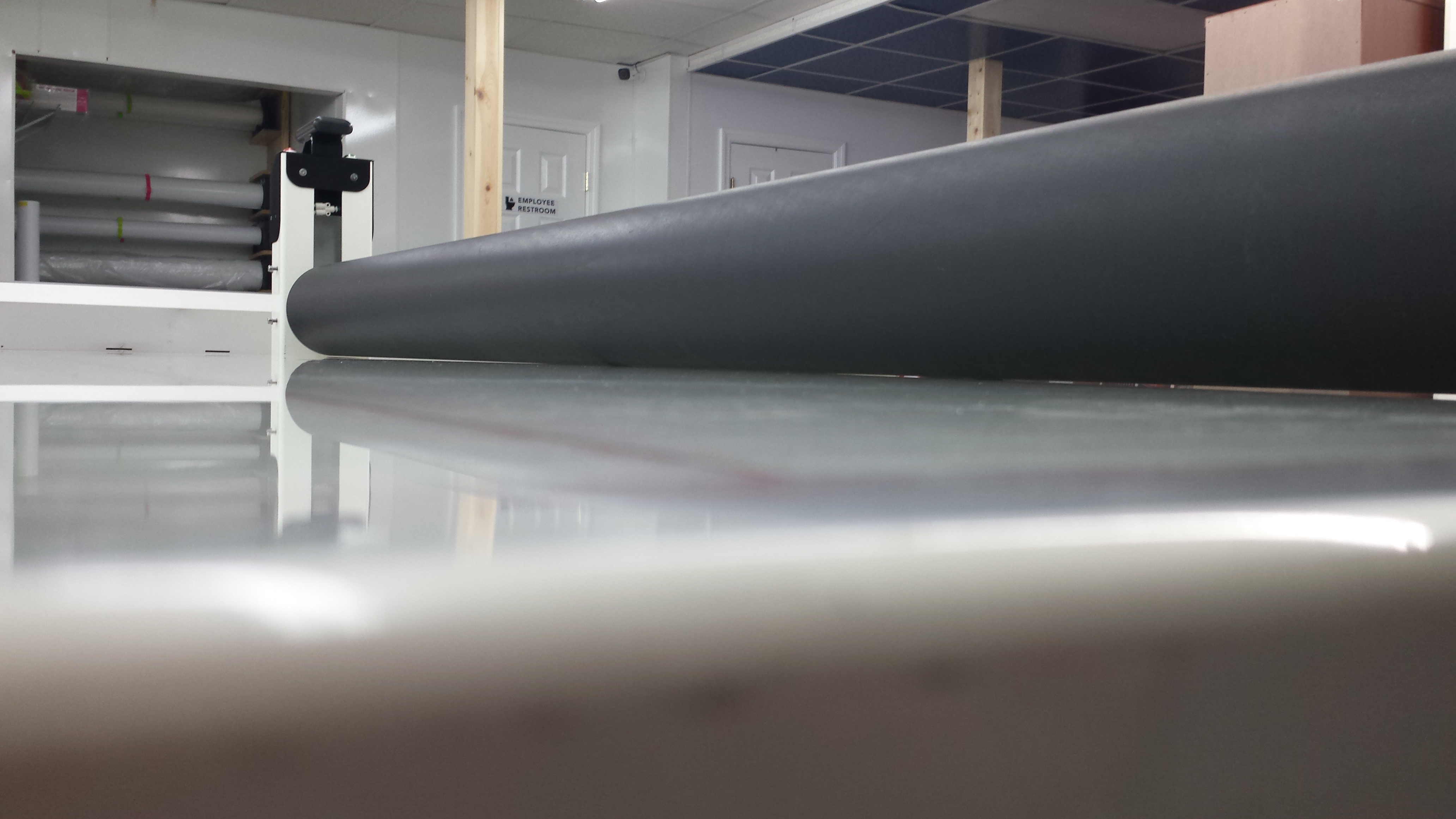

Our new RollsRoller will be delivered next week. I looked at a bunch of different tables and decided on the RollsRoller. These guys are the originators and I feel build the highest quality table out there. My buddy has a CWT and it bows in the middle so the roller always rolls to the middle. I'll post pics and video soon!

My CWT table has a slight "bow" in the middle but it flattens when the roller is in down position. I laminate & mask 12 to 14 foot lengths with no problem at all.
I have included a picture with the roller just touching the "hump". This is with no pressure on the table. This is gone with the roller in full down position.
