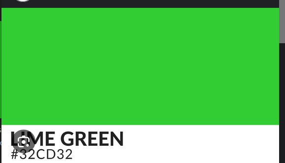

Hy
I'm using my espon 80600 with onyx and also have an old caldera wich can be run with it too, and i 'm looking for help to create a profile to hit the Green KAWASAKI.
Can anyone help me giving tips on ONYX or calera to get this color?
Thanks for watching.
Regards
I would start with one of two ways.
1.) Pull up an image into ONYX that has the kawi green in it (like the attached) and open it in the job editor. Go to the preview and size tab and hover over with the cursor so you can see the CMYK build of that color. Write down the number values and you can use them in the SWATCH BOOK option on Onyx Thrive.
https://help.onyxgfx.com/21/ProductionHouse/Content/Swatch%20Books/Swatch%20Books.htm
When you open up the swatch book window choose CMYK from the drop down menu. Make sure you have the correct printer selected. Enter the values you obtained from the image and you can print a bunch of test swatches out.
2.) Find an PMS color that is close to watch you need and start with that. Do the same process as above but from the drop down you would select PMS instead of CMYK.
