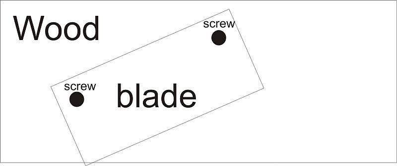

d fleming
Small piece of wood, razor blade, small screw. Screw the blade on the side of the wood leaving a small bit of tip exposed, slit paper. Once you get it set right it will go quickly. Fasson makes a crack n' peel psa vinyl as well.
