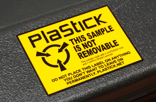

B Snyder
PlaStick from Graphic Marking Systems fits the bill.

petepaz
if all else fails you may have to get a roll of 3m adhesive and print on a non pressure sensitive material then mount the 3m adhesive to the print
we use 9471 or 9472 both work good on low surface energy plastic
we use it on molded plastic cases, vinyl patches and covers we also use it on a tool a customer has but it can be oily and it's the only thing that sticks
if you decide to go that way and you can't get the adhesive i might be able to get it for you we deal direct with 3M
