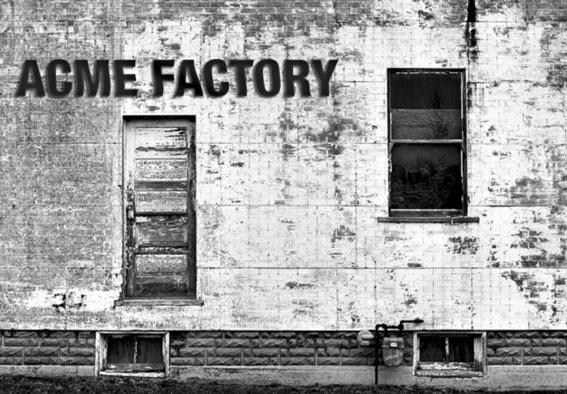

John Butto
got it right this time
..just installed 12'x.125" black letters
