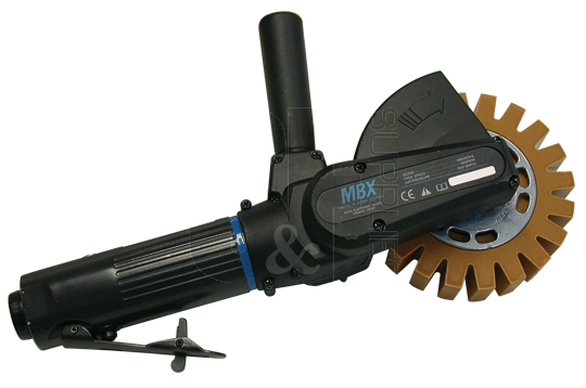

Yea, very clean stuff to work with and works instantly. I buy them by the case to get a discount. Also good for getting oil based paint out of you clothes and scratches out of ACM.
Fuel Media
vynil zapper
