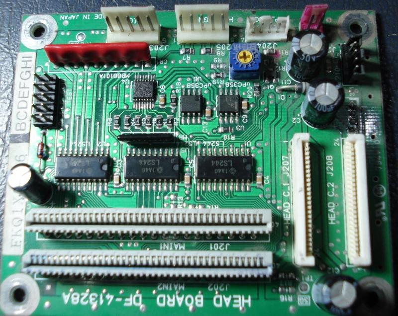

need help with my mutoh rj 6100
astro8
Are all 6 coloours working? I can't see light cyan and light magenta?
Do you have a rip to print through? What's all that 'gobblygook' text I can see?
Did you syphon ink through your heads to make sure they are primed?
Are all your head cables properly seated? It's easy to overlook that and you'll get what you are seeing in your pics. Make sure you turn the power off and pull the plug from the wall as you'll blow the fuses or boards if you mess with your cables with the power on.
mo_alhawary
you can't see the light cyan and light magenta in the nozel check but now all the 6 colors are working
no I don't have a RIP.
I don't know what is this text the printer printed it by it self.
all the heads are primed .
yes I think that I messed with the cables with the power on
so you think it's the boards as the F1 and F2 fuses is ok
do you know what to check after the fuses ?
and if I have to change the boards where I can find it ?
Thank you for your help
mo_alhawary
the head borad

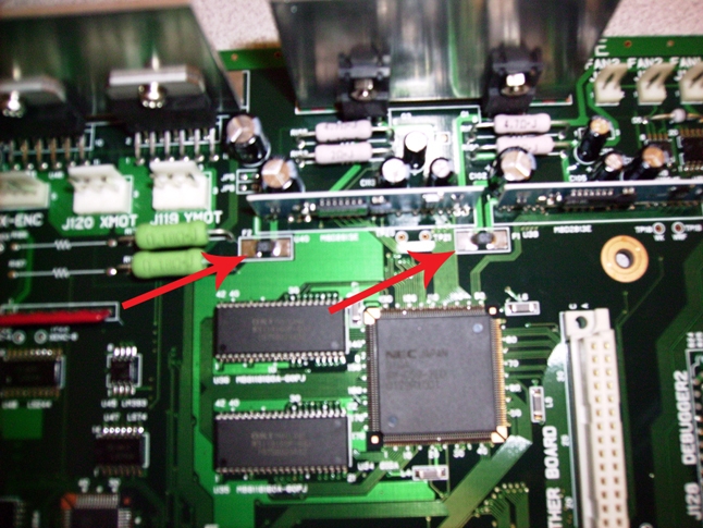

Here is link that can help
http://www.signs101.com/forums/showthread.php?t=54941&highlight=head+fuses
I think that attach picture show head fuse location on main board.

the head fuses are OK I think the problem is in the head board so I will take it to check .we have a company that can fix boards. so wish me luck
