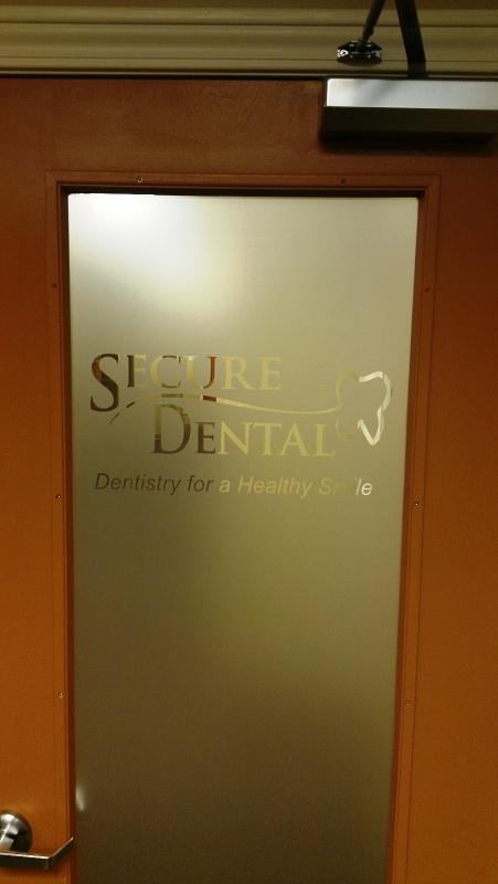

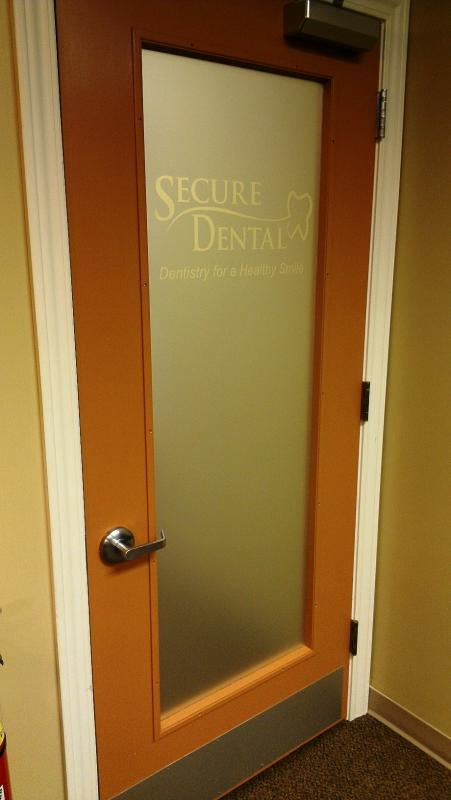

    install successful!
    Thank you all for the tips. Second time was a charm.
    I masked just the logo, soaked the glass and vinyl, butted the top & left edge, and trimmed the remaining on the bottom and right. The Oracal seemed to be pretty good stuff, I had no problems with wrinkles whatsoever.
    Customer is happy, I'm happy :thumb:
    Hard to get decent pics of it but here's a couple
