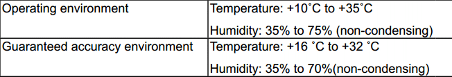

I'm really surprised the plotter itself will make the adjustments necessary for a crooked/stretched print, but as I think about it I don't know if the pc or the plotter makes those calculations when it's traditionally set up. It's not surprising that the machine can do it, more than they would put enough electronics for it to do it without adding too much cost. Then again the unit is probably spec'd for 'office use', so it may be susceptible to moisture and dust as a trade off to using more expensive parts. Is this in a totally uncontrolled area of your shop?
Had to pull this out of the service manual oddly enough.
We have A/C in our shop and a big dehumidifier, try to keep it around 78 and 50% RH
