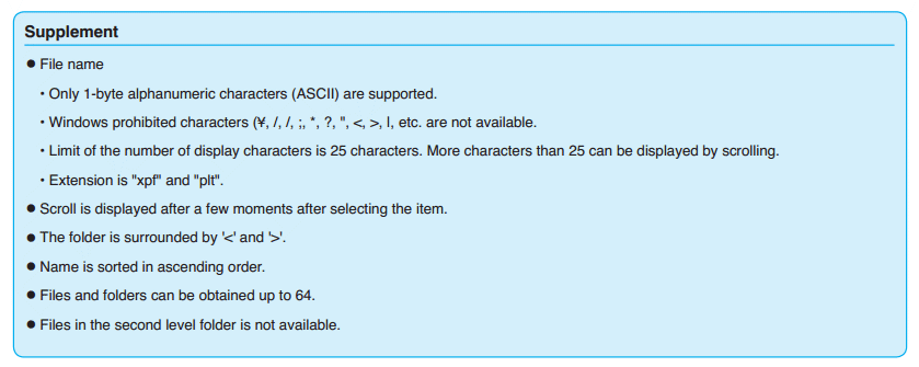

As far as the thumb drives not fully registering, it's likely because there isn't beans in the machine in the way of processing power. Here's a section out of the manual, which I don't fully understand, but it sounds like you can't have more than 64 files and folders displayed, and you can't travel any deeper than one level in the file tree. Pick up a 2gb stick, keep the file count to a minimum, and I guess don't bury too much down into the file tree.

If the flash drive just working as it should is your biggest issue, I'd get a handful of smaller ones and start testing to see if you just have too many files on them or what. You may need a host of them to fulfill all your different customer's repeat orders, but that wouldn't be a tremendous investment, just pita.

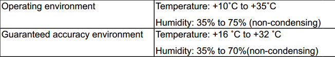

I'm really surprised the plotter itself will make the adjustments necessary for a crooked/stretched print, but as I think about it I don't know if the pc or the plotter makes those calculations when it's traditionally set up. It's not surprising that the machine can do it, more than they would put enough electronics for it to do it without adding too much cost. Then again the unit is probably spec'd for 'office use', so it may be susceptible to moisture and dust as a trade off to using more expensive parts. Is this in a totally uncontrolled area of your shop?
Had to pull this out of the service manual oddly enough.
