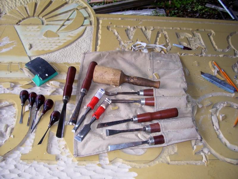

    Here's your basic tools on carving,,,
    I've found power tools can get you into
    trouble pretty quick,, so I prefer the old
    school hand tools,, they stop when you
    want them to stop,, but to each his own !!!
