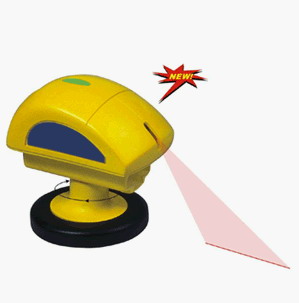

We've been looking to add a cnc to our shop as well. I see that those from MultiCam, Vision, Colex, etc, all have a camera registration systems. Can someone with a shopbot or similar CNC without a camera system talk about the process of contour cutting pre-printed printed boards? Is it possible?
artbot
i print cross hairs or a tiny "trim to" line around the part, then i paint the cnc table with lasers from above. line the printed target up with the edge of the laser and cut. the zero corner on the print will be the zero corner on the cnc. there will be a long line running down the x=0 and the y=0 the full length of the table.
the "lase-ed" line is about 1/16" wide so it's usually accurate within 1/16". i suppose with a better laser one could drop a finer/brighter line on the table and really get anal about where to place the part. it's very quick. surely quicker than having the cnc run to three corners to register.
