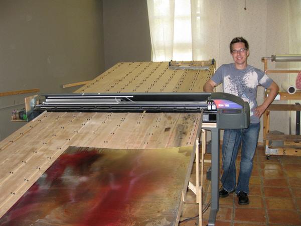

i tore one apart and printed on 5x10 aluminum for a while. they are complete crap.

Thanks artbot, I'll ck out pinebrush. Why were you printing on metal and how did you keep the ink from smearing? That is a impressive set up you did with the 600e, how long before you had to replace it?

i used it to print white. what back before white was available for even the grand format printers. recently i bought a jv3-160sp to print solvent white. but lately i've been putting my old water based formula in the mimaki. doesn't give me the 720 resolution but is completely opaque. and it takes up less space.
the nice thing about metal, you adjust the fluid tension and print mode just so, then you torch the crap out of the sheet with a propane torch (like the one that you would use to torch down roofing).

first try slowing down your head carriage speed, and or additionally unidirectional. you might be going too fast for the ink to get through the system. after that increase the heat on the cartridges. this will lower the viscosity of the ink. if worse comes to worse tear off the cartridge bay on the left and put in a home made cart rising thingy. you can see one on the left of my machine on the ramp. this will allow you to "over" raise your carts to the point that they are really laying down ink.
