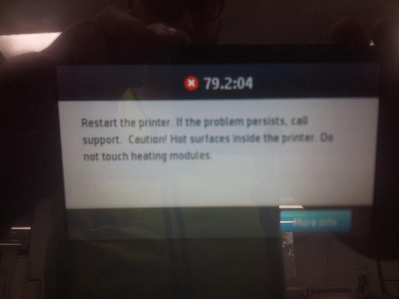

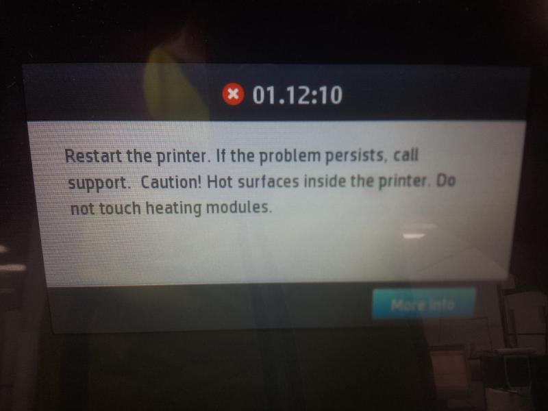

Since installing this new firmware we have had a plague of problems... not sure if related though. HP seem to think it's a hardware fault and have replaced half the control boards in our L360 and still no good. HP here down under have never seen these errors before on this machine and are stumped imo. Really poor service as well taking days to get parts in while out machine is down and production is totally halted. I now have a box of spare parts enough to nearly build another machine haha
Hi Davo,
I have exactly the same problem (error 79.2:04) with the last firmware. When did the error appeared on your printer?
Davo
Pretty much just after installing the new firmware, maybe a day or two later. Then the printer started having trouble resuming from sleep and the psu died.
lerouxjul
When the printer still working with the new firmware, was it possible to print with?
What happens when the psu died ? Printer stay off, no led light ?
Davo
Yes it worked for a little while then it died. The printer would not resume from sleep without crashing the software.
lerouxjul
OK, if I print 10 times, I have to resume printer from sleep 10 times. On these 10 times, I have 8 times perfect resuming without any problem, and printer works good... but I have about two resuming crashing (error 79.2:04) and then, I just have to full switch off the printer (using rear switch) and then full restart printer and then I works correctly.
I feel that I have less and less this error 79.2:04 because one month ago, on 10 resuming times, I had about 5 resuming crashing...
Before replacing PSU, it was always impossible to resume your printer from sleep without crashing, never ?
Davo
It was fine until I started getting these firmware errors, then it would resume fine 5/10 times then it got worse and worse until one day it wouldn't resume from either network or front panel. A whole bunch of parts were replaced, the HP technician diagnosed it as faulty PSU but it was the last thing replaced.
