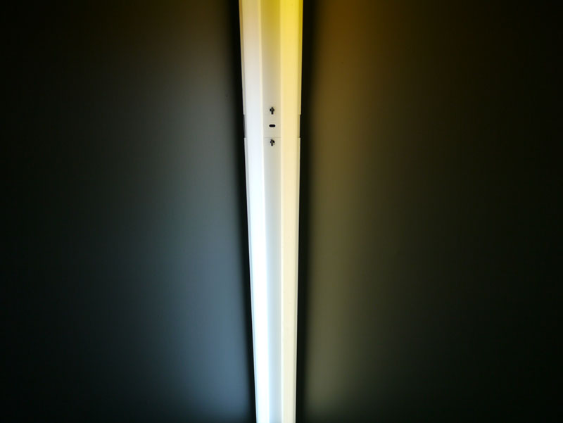

I have 8' long fluorescents directly overhead (10' ceiling) and they are Philips 110 Watt 4100K "Cool White" tubes. I just talked to a guy at a local commercial lighting store and he recommended that I use 6500K "Daylight" tubes for better colour rendering, but more importantly that I change the ballasts from the 10 yr old magnetic type to the newer electonic type. They cycle much faster, and are quieter. I think I'll do this.

I had my wife pick up the tubes and ballasts on her way home. Popped in just one tube and wow, what a difference! It's more dramatic than what the picture shows. It's like white next to peach.
I'll be putting the ballasts & remaining tubes in tomorrow.

***Just got all the new 6500K "Daylight" tubes (and new electronic ballasts) installed.
HOLY CRAP!!! What a difference! Should have done this years ago.
Colin
I don't know, I'll ask my friend who's an electrical inspector.
My new monitor which I thought was really bright now appears duller. I guess I should jack up the brightness a bit.
And from outside at night, the light emitting from my shop windows looks like there's a super-nova going on inside!
