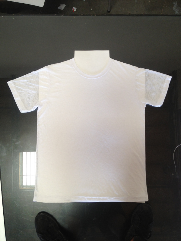

    I've seen guys using inserts to help spread shirts. What are you using to make these? Posterboard? Then.. Do you reuse them? Wrap them in paper each time?
    How about for the collars. Anybody have anything that lasts for multiple shirts or do you just throw some paper in there and toss it? The first shirt we printed we forgot to cover the collar area and pressed through the back. Hahaha! Lesson learned.

    It's ok.. I'm ingeniituve. Heavy tagboard works great. 24x36, a hundred sheets around 50$ online. Cut the tagboard angled to fit shoulder and left a portion for the collar. Slides in fast and saves on setup time.
    Now, I'll just keep a original for each style and size we offer. Should last a couple hundred hits especially if we throw some tissue paper on top.

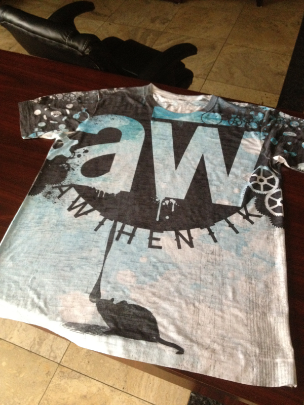

  6. JoshLoring
    JoshLoring Very Active Member
    I will mud! Just went to NBM at Long beach and learned a lot! The manufacturer was there and said our big press comes first thing next week! Stoked!
    We made some shirts just for the show an got awesome response. A lot of people thought we had done cut and sew. Funny! Ask Chris at AZ Pro. He was there too.

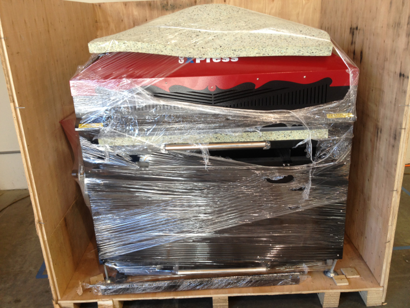

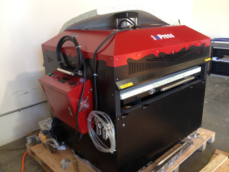

  7. JoshLoring
    Update to all interested.
    Just got our new press crated in. It's getting setup next week and we will spend a bit building out around it for output.
    Looks like a transformer.
