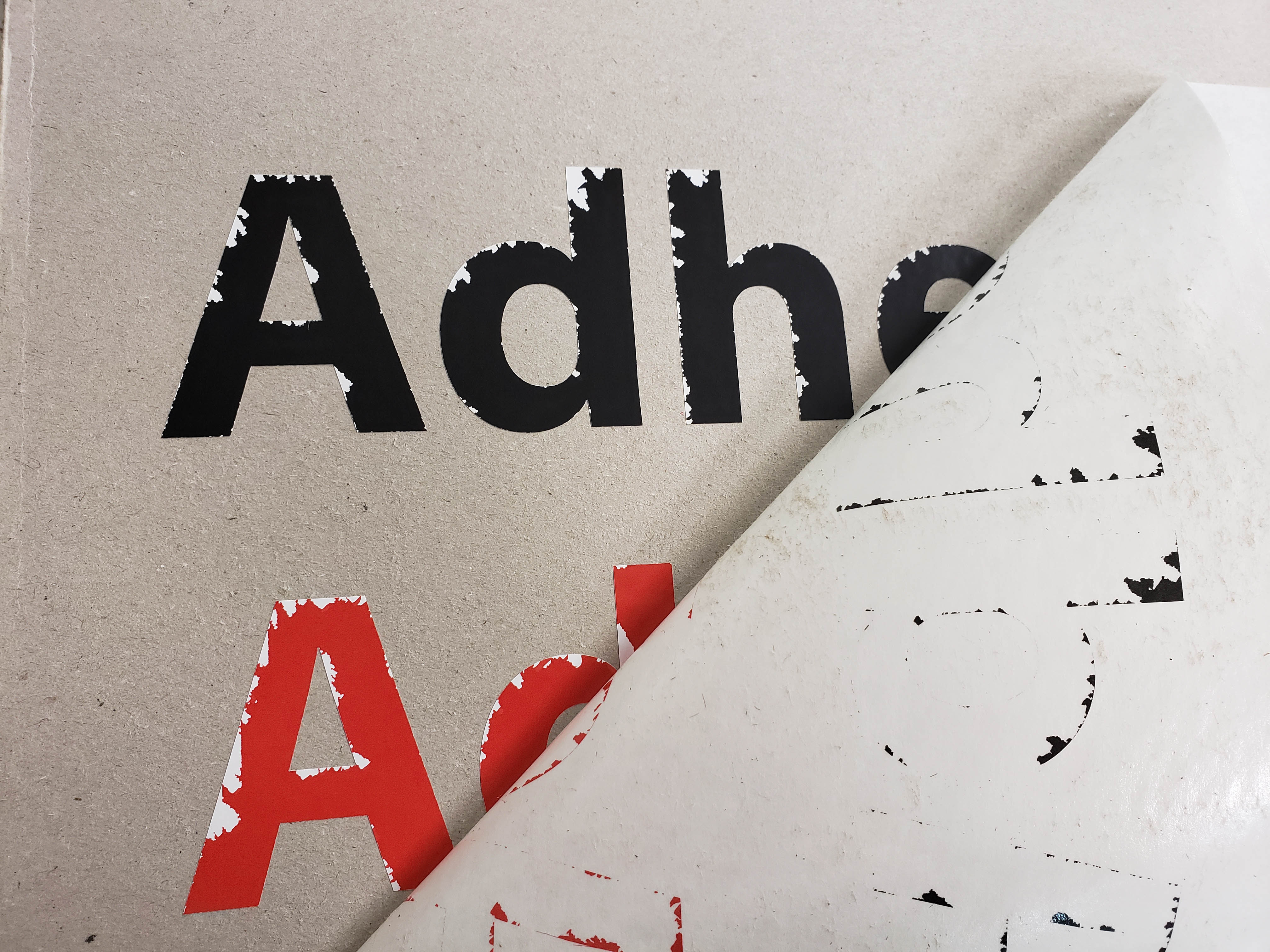

We have had a Colorado for about 6 months and honestly have had a lot of problems. For one, don't try to print to adhesive vinyl/weed/transfer paper. Most colors the transfer paper will pull the ink right off of the vinyl.

Jim are you using the current ink and firmware ?
I'm curious because the first versions from last year certainly did what you've shown, but the tests we did ourselves (Oce let us loose on their Colorado for a few hours) were significantly better.
With the 3M and Avery cast we used the ink can't be de-laminated, even with urethane laminate after 4 weeks.
Did we just get lucky, or is it Cast / Calendared specific do you think ?

Did canon let you use your own materials? They may have let you loose but if they’re determining all the factors they’re going to make sure you’re using absolutely the best media/profiles they can. Whereas a regular John Doe might not be using the same materials.

No, we're up with all the dealer "smoke and mirrors".
We drove it through Onyx with various profiles, took our own media, and used it ourselves.
The ink certainly bites better to cast than calendared, but that's true of every printer process, solvent, latex, or uv.
On calendared we did a lot of cross hatch slicing the ink and trying to lift it on the cut edges with the same vinyl; much stickier than app tape.
We did see a little edge flaking on the calendared vinyl, but nothing like Jim's picture.
