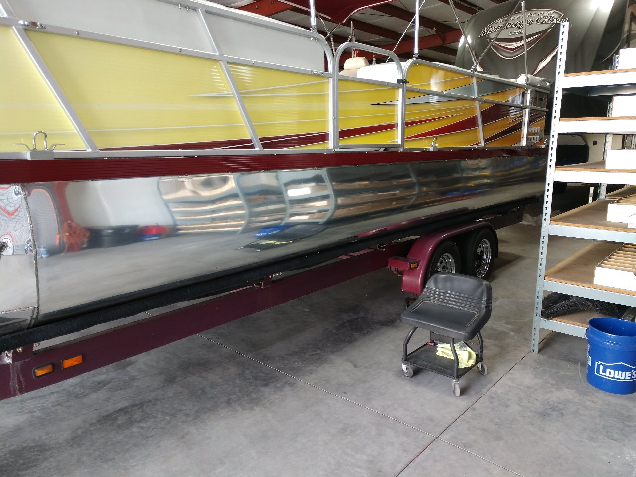

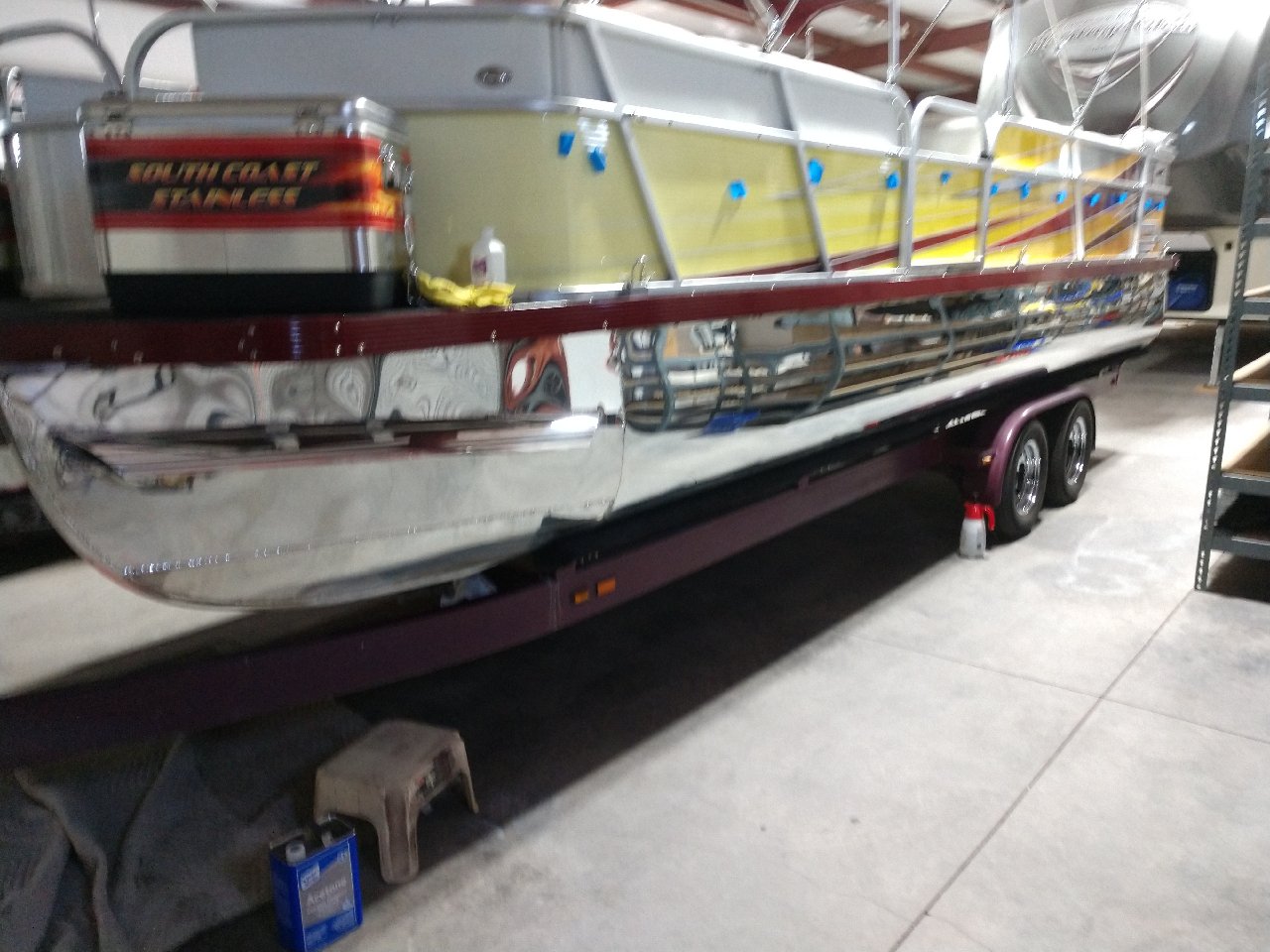

    IMG_20190609_143422996.jpg IMG_20190609_163037602.jpg Hi all,
    I have a unique situation. My pops has a tritoon boat, the toons have been polished for a number of years. We are trying to find a different way to protect them from tarnishing (they oxidize, even after one day on the lake). We have been using a product, called Sharkhide, unfortunately they were bought out a couple years ago and they changed the formula.
    I got an idea that putting laminate over it would protect it. I have tried Oraguard 290-f, but still not satisfied result. I am calling out to see if anyone knows of a lam, or other material, that may be clearer for a better result?
    Attached are pictures of the toon, one polished w/ no laminate, the other w/ laminate. It looks better in pictures than in person.
    The wrap itself was done with 3m IJ180c w/ 8518 lam. It sat outside, in the Lake Havasu, AZ sun for a couple years before the garage was built, with no visible fading.
    Thanks
    Dennis

    The toons had been stripped of the Sharkhide, then repolished by hand, my Pops is retired (I wouldn't have done it), we are just trying to come up with something. The second picture was wrapped with the laminate. If I can come up with something that is up to my standards, it would be an added source of revenue, as I know a lot of people who would jump on board with polishing their toons.
