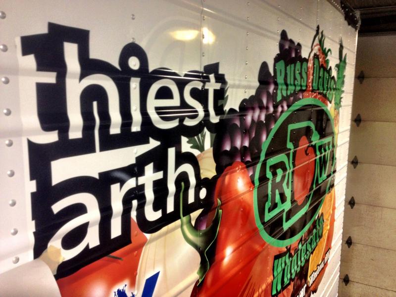

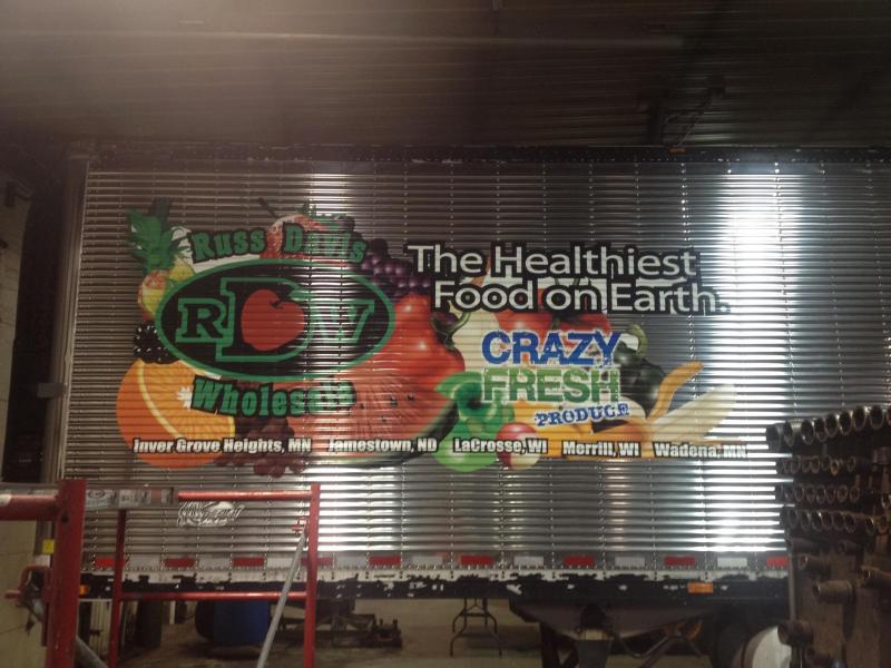

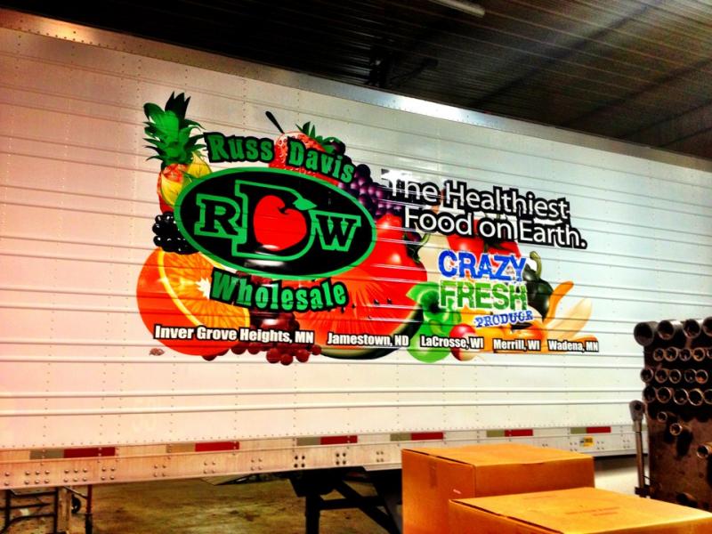

I would be afraid that it would over stretch the vinyl. Just watched a video pointing out that you shouldn't stretch the vinyl more than 30%. I was using oracal 3551RA which is speced for slight curves and rivets.
You asked for advice. I have done over 60 of them some of them over 5 years ago and no failures or issues. Start at the top and pull all your backing off. Rub onto each rib top and then rolle pro into each gap. Makes alignment easy and does NOT distort at all. I use Avery MPI 1005 EZ RS.
Since posting that I have been rethinking this and now see how it would work perfectly. Actually the wider the gap the less the material is stretching. Probably would have taken a third of the time. :banghead:
Question, ok you span the ribs and when you roll into the gap I would assume you you would start in the middle and work towards each rib? that way the stretch is evened out? Or do you just go top to bottom.

Start at the top of the trailer and hinge the material like normal. I then peel off the entire backing and just rub the material onto the HIGH side of each rib. Then use a rolle pro to feed it into each gap with heat.
