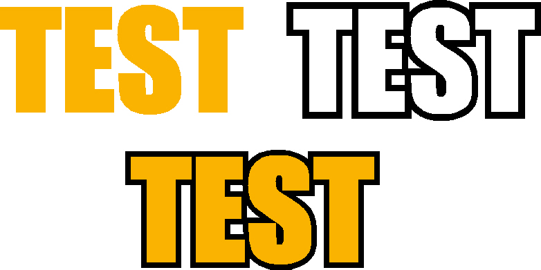

What ever you do, make sure you put the black down first...or is it the other way round?
actually i'd put the yellow down first and the black on top.....otherwise the yellow might be dulled down because of the black underneath....yellow with a little outline...black with the original text cut out....creates a choke/spread....
i don't do this with all color combos...but would definitely do it with black and yellow
