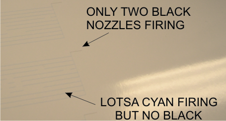

Was printing fine earlier today. Already did a manual clean and a soaked rag head clean. Also several STRONG cleanings with no change. Also printed a 36x6 solid K block... it came out as just some dots (the two working nozzles). Also rebooted the printer.
Any other ideas??
Nozzle check image attached.

SignsOfMaine
Aside from cleaning the heads in the usual way, are there areas where there's exposed circuitry, or areas where the heads touch the printer electronics, to cause it to not get firing signals to those nozzles even if they're clean? Our old encad had gold circuit lines on both the printer itself and the head... if they got dirty, the heads never even knew to fire some of the nozzles.
Got any old heads you can stick in there to test with, maybe one that had some bad nozzles (but if that one also fired only the same two nozzles, then you'd know it's not the head itself)?

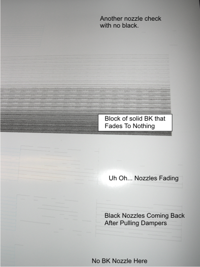

jiarby
Uh Oh... I wrote too soon!
The nozzles are gone again. I suspect that me futzing with the nozzles with the cleaner swab is what gave me the nozzles back, but they got worse and worse with every check and now I am back to none.
I'm going to replace them tomorrow.
