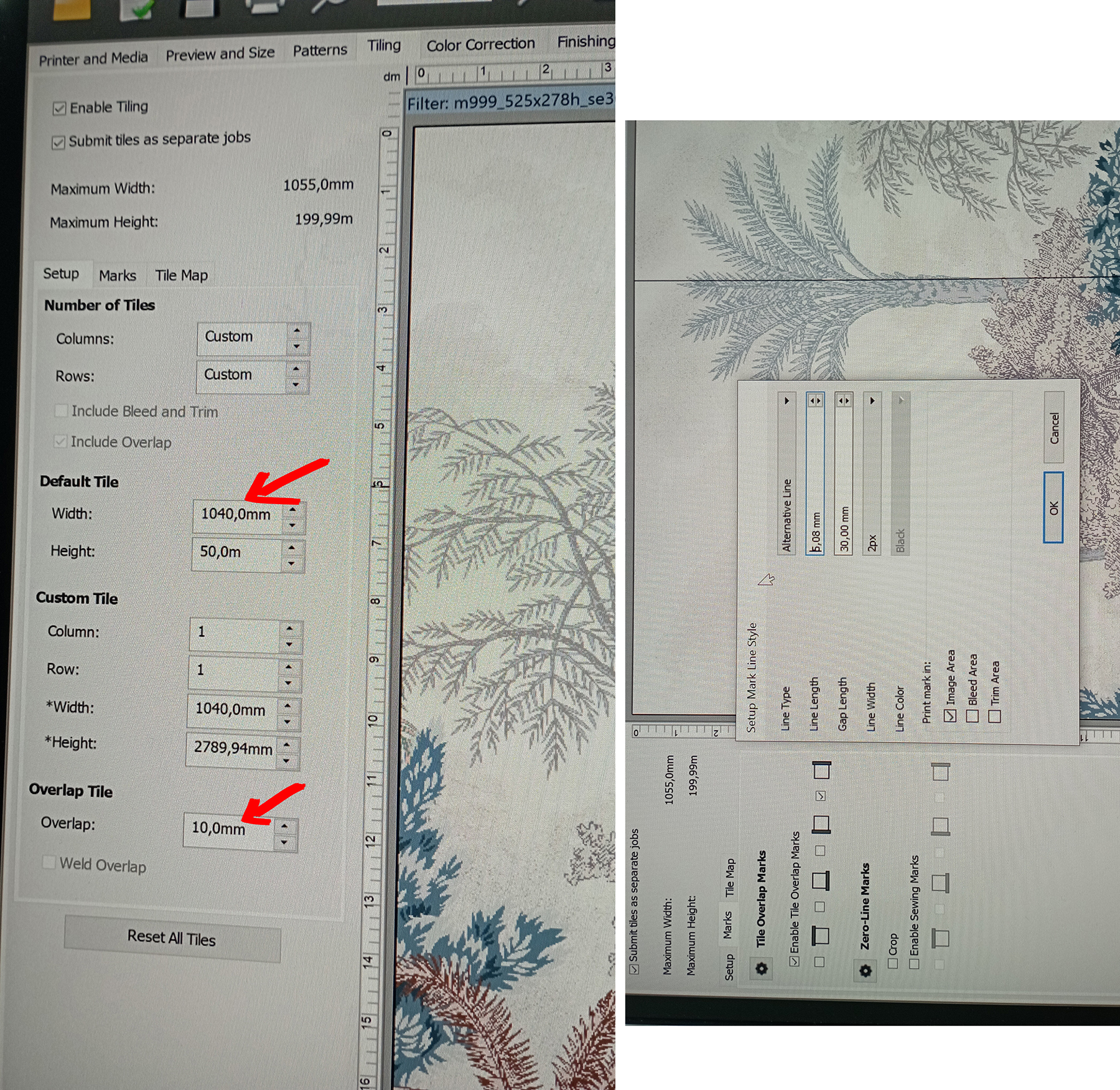

placement set + selected media: m2jpg
tile overlap nd marks set : m3jpg

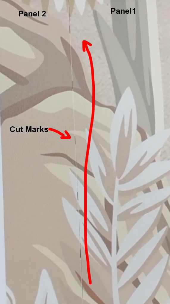

overlap problem: m4jpg ( you can see the overlap problem)
cutting marks: m5jpg (When I cut from the cutting marks, there is no weld two panels.)

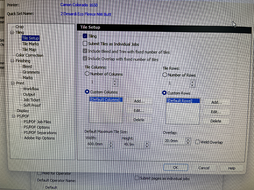

I’ve attached the settings we use.
