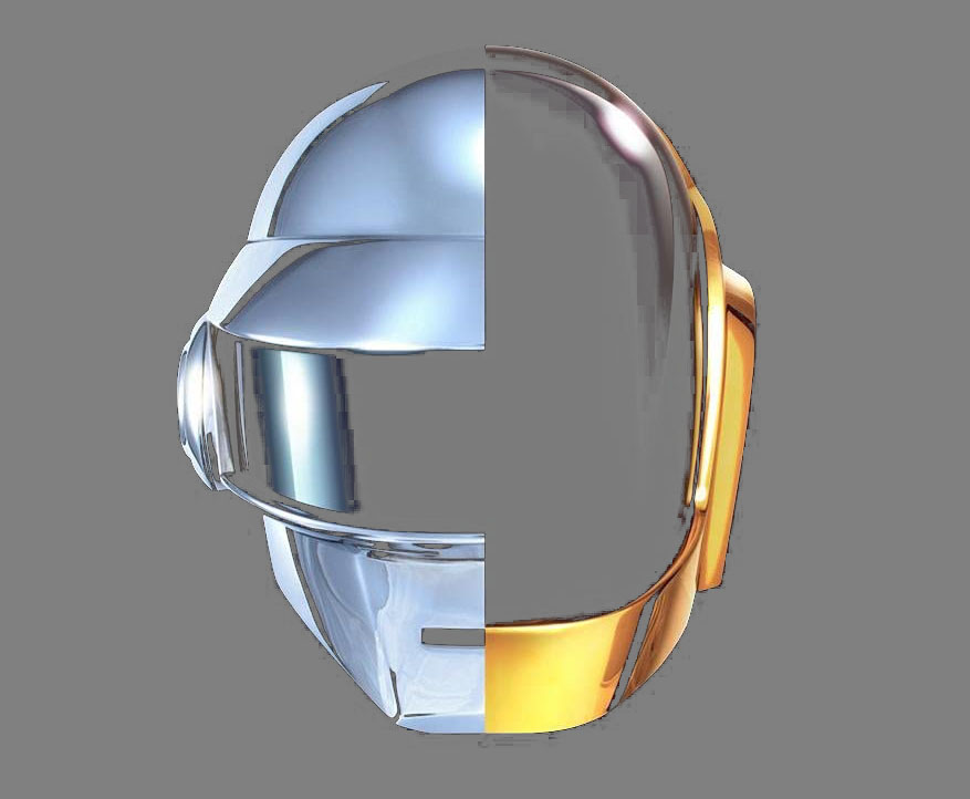

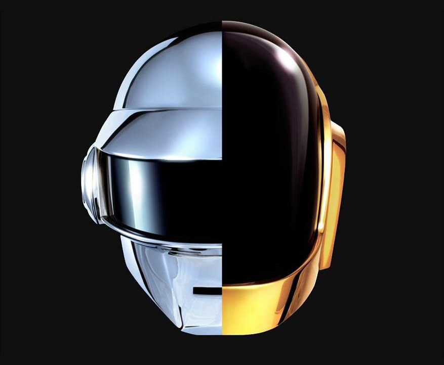

I've found a random image and made a modification to it to show what I think would need to be printed. Using a OCE Arizona 360GT with white ink for printer reference.
So if you imagine this printed regularly (on a white substrate) it would just print all the black areas. But I would want it to NOT print the black, as the substrate is black anodized aluminum, and need the anodizing to show. But would also need a white base layer so that the colours will show up correctly.

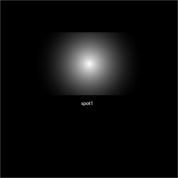

So to show what I think would be needed, I made this "preview" to show what my mind says would need to be printed. Just the center image, and no ink laid down where it's gray in this image:
Does this make sense? Is there anyway to set this up in the RIP? My thought is to make a vector file for the white background base layer, print that first, and print the image with cmyk on top. It won't be this exact image, but I think it will serve to illustrate my thought process.

Just imagine it like additional ink. You can do everything you could do with cmyk.
On your picture make it negative and change the color to Spot1 and import to RIP. You will print that on black just like in your image.
