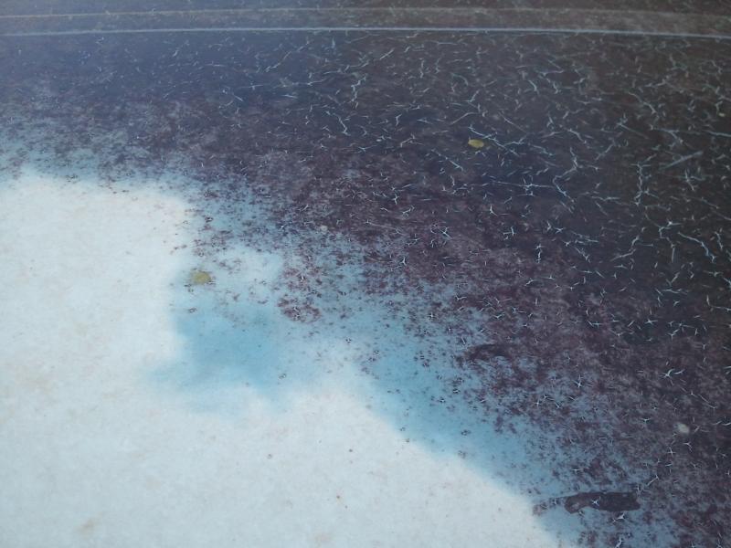

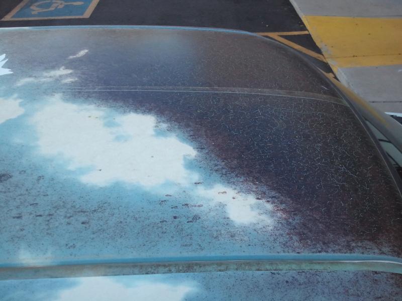

Yeah, I don't use Arlon. Seen this too many times to trust it. All within a year. In 2011, Arlon replaced 4 rolls of material for me. Didn't replace my labor though...

Wow, interesting pictures to say the least. I can appreciate your hesitancy in using their products. However they have been aquired from FlexCon since then and share some of their standards. Arlon has a top management team and seems to be a classy organization. Might be worthwhile to take a look at using again. Every vinyl manufacturer has bad rolls from time to time.
