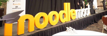

We used the corded Graco from home depot ($250.00)
The letters we produced are installed indoor.
I hope the paint won't fall off.
Next time we will use a primer.
