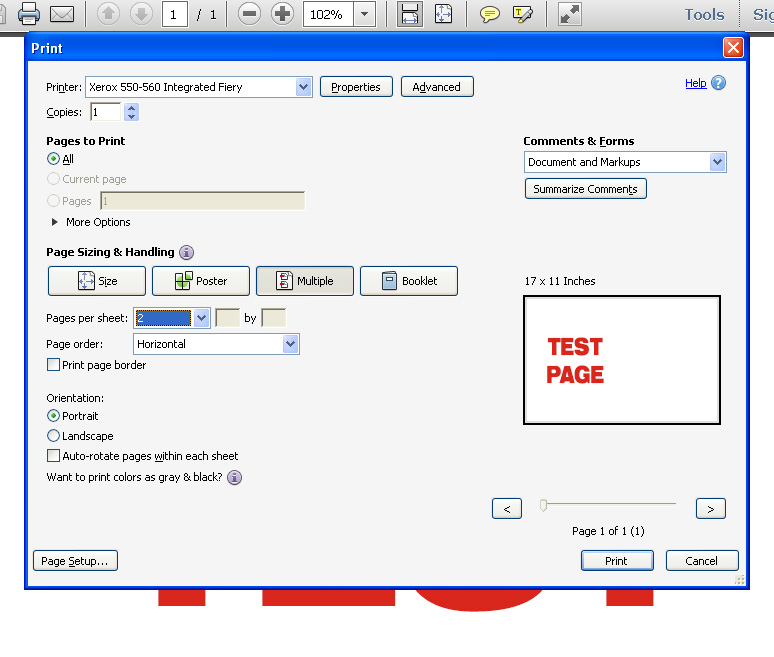

evader
Can't get it to work for some reason.
here is a screen shot of what it looks like when I try...
evader
jhilldesigns - how do I duplicate the page in acrobat reader?
xxaxx - changing it to say 2 copies doesn't change anything
