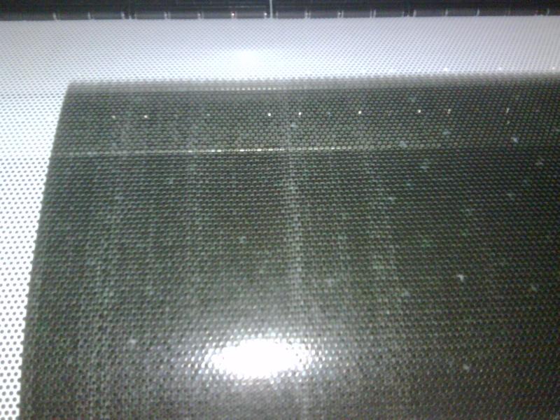

We are getting these streaks on our perf. We moved the image on the roll to the left & to the right & the same streaks come up in the same poistion . Anyone have a clue what is causing this? Only on perf material

I am assuming you are printing on white? I would think the head is hitting the perf (perf sticks up a little higher than regular vinyl. This is just an idea...

What we noticed when we enlarged the image on our screen, you can see that the lines are showing up where ever the gaps show. This is 50/50 perf. We just tested 65/35 and it didn't happen, maybe cause were at the end of the roll. But even then, at $600 a roll, the whole thing should be good. And if that's the case were going only for 75' from now on.

id chime in, now years after the fact, that the streaks you see could be a non-issue. Just ink pooling in spots in the clear backer, that won't show up in your final application.
Dial-up the pass rate to the max and these will possibly disappear, as well.
