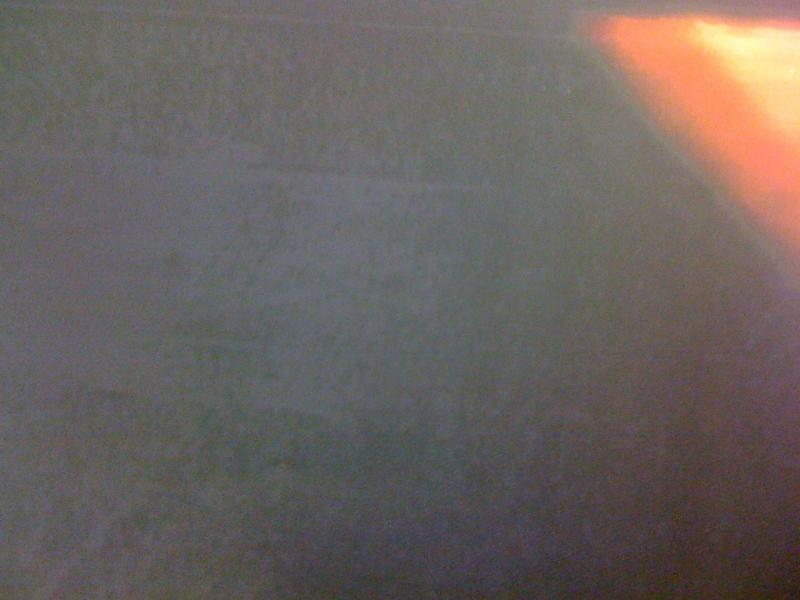

We had a roll last fall that looked and worked great. The roll we just got looks horrible, there are streaks and lines in it, and where we print in dark areas, it looks like the ink is pooling. This is not the same stuff we got last fall. Anyone else having issues with this?

We did return it and the next one was the exact same thing. We returned that one and asked the dealer for a different lot, and that lot was the same. Now I'm wondering if I'm re-acting.

I just printed some mostly solid black Phototex panels with a Mimaki JV33 and was having the problem you described. I adjusted my heat settings lower and didn't use the take reel and the problems went away. I think it was a problem with the material slightly buckling and making the print inconsistant.
Phototex is also very to contaminate with with oil from your hands. Make sure to be careful when handling the material. The first wrap of the roll always needs to be thrown out as well. Good Luck.

We noticed it looks fine if we don't use the take-up reel, however even if we let it sit flat overnight, then roll it up to ship, the black area then will look bad.

We use and love Photo Tex, maybe take your black down 20% as the issue may be the change in humidity in your place as it changes when using air condition to heat and this may be the issue with printing heavy solids. Otherwise, contact phototexgroup as they are wonderful in taking care of any questions I ever asked. I tested all the others and nothing worked indoors and outdoors like phototex. Tracy
