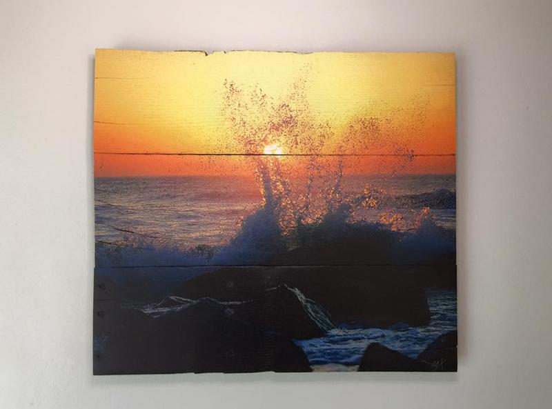

Tim4
Direct print on wood
There is a local photographer that produces prints directly on wood. I don't think he runs anything but his own prints but it is an example of the possibilities.

BillyBoy86
A flatbed printer would get the best results.
i'll have to see if the local guy i deal with will print wood. i don't have a flatbed myself. if i go that route, i wouldn't need to engrave anything,....i could just print the quote as well
