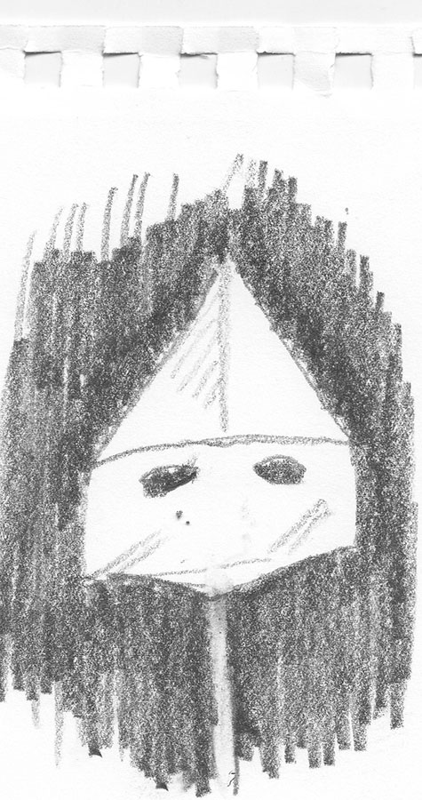

Pillowcase, light up at night, next he tells you he needs two black ovals on it.
Is this for a customer that has Grand Wizard in his name?

I was told this was only to be up for 30 days... Well, 1 year later it's still up... thankfully it looks like the day it was installed. This covered a fully intact flexface. I switched the lights off for obvious reasons.
