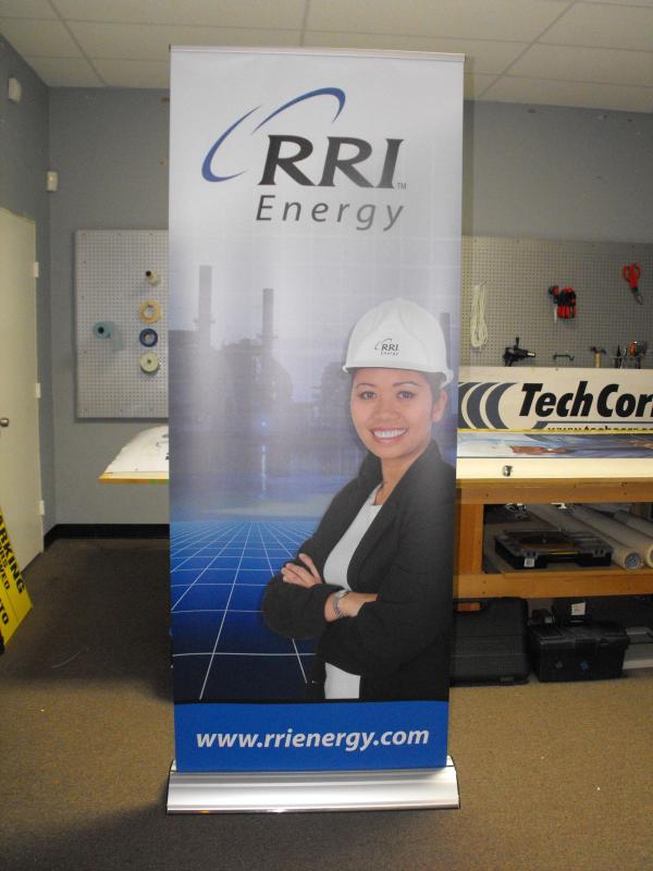

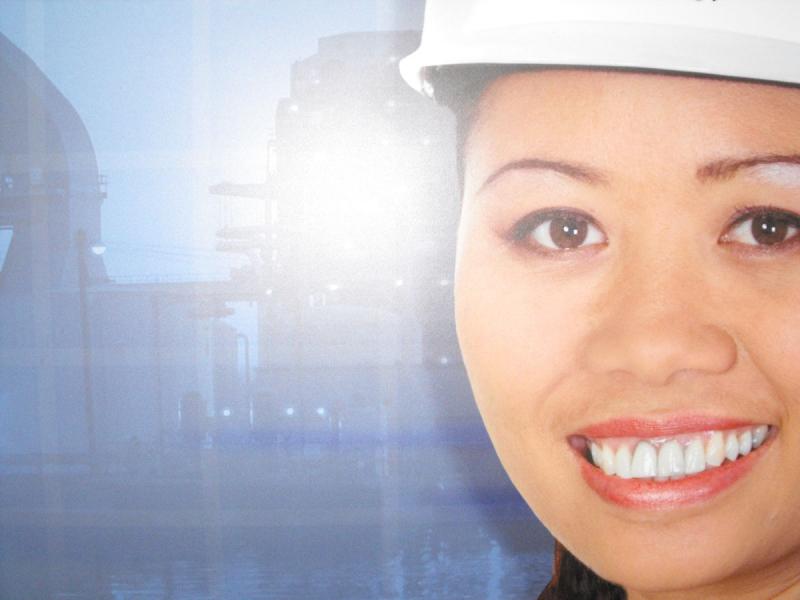

    I just wanted to say that the PopUp product from Fellers prints like a dream. Ran it in high quality mode and there's not a hint of banding or anything. I laminated it with Oracal 210 matte. We'll see how well it holds up in the retractable. I'm totally happy with it so far.
    Here's the first in a series of prints we are doing. It's hard to get a good pic with the flash on... but you'll get the idea:

    Pop Up with Oracal 210 Matte lam is dirt cheap to produce and looks like a million bucks.

    man, you shoulda `shopped that girl's grill a little

    Hey GFX what kind of banner stand did you use? Is that one from Fellers?

    You're so right jiarby... she had some funky teeth.
    mosign, it's the supreme retractable from creative banner. it's a bit pricey, but the best retractable i've ever used.
