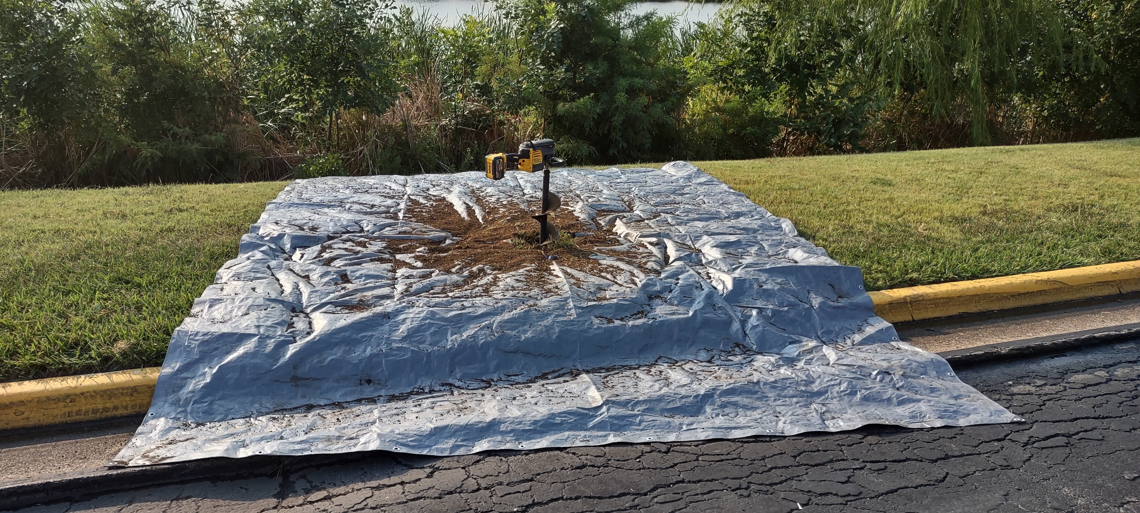

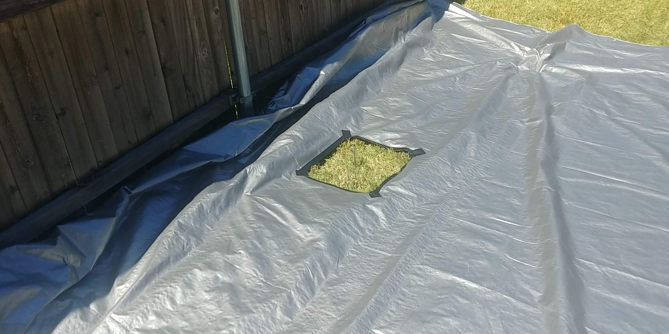

Augers tend to throw the dirt pretty far which typically results in a bunch of time spent on clean up if you're in any kind of 'finished' area. My solution to this is a heavy duty tarp with a square cut out of the center (I 'sealed' the cut edges with Gorilla Tape so it won't fray). I place a safety cone where the hole needs to be, then spread the tarp over it so the hole goes around the cone, move the cone and then auger the hole. After augering the hole, the spread out dirt is easy to either broom or tip into a pile with the tarp, and transfer into a tub, bucket, etc.

This is a great idea! I use an ice auger also and boy, what a mess!

It works especially well in cases where you don't have to use concrete. A helper and I set 8 posts yesterday and it took about 5 minutes per sign to lay the tarp out, auger the hole, set the post in, tip the dirt back in/around the post, tamp it down and screw the face on.
