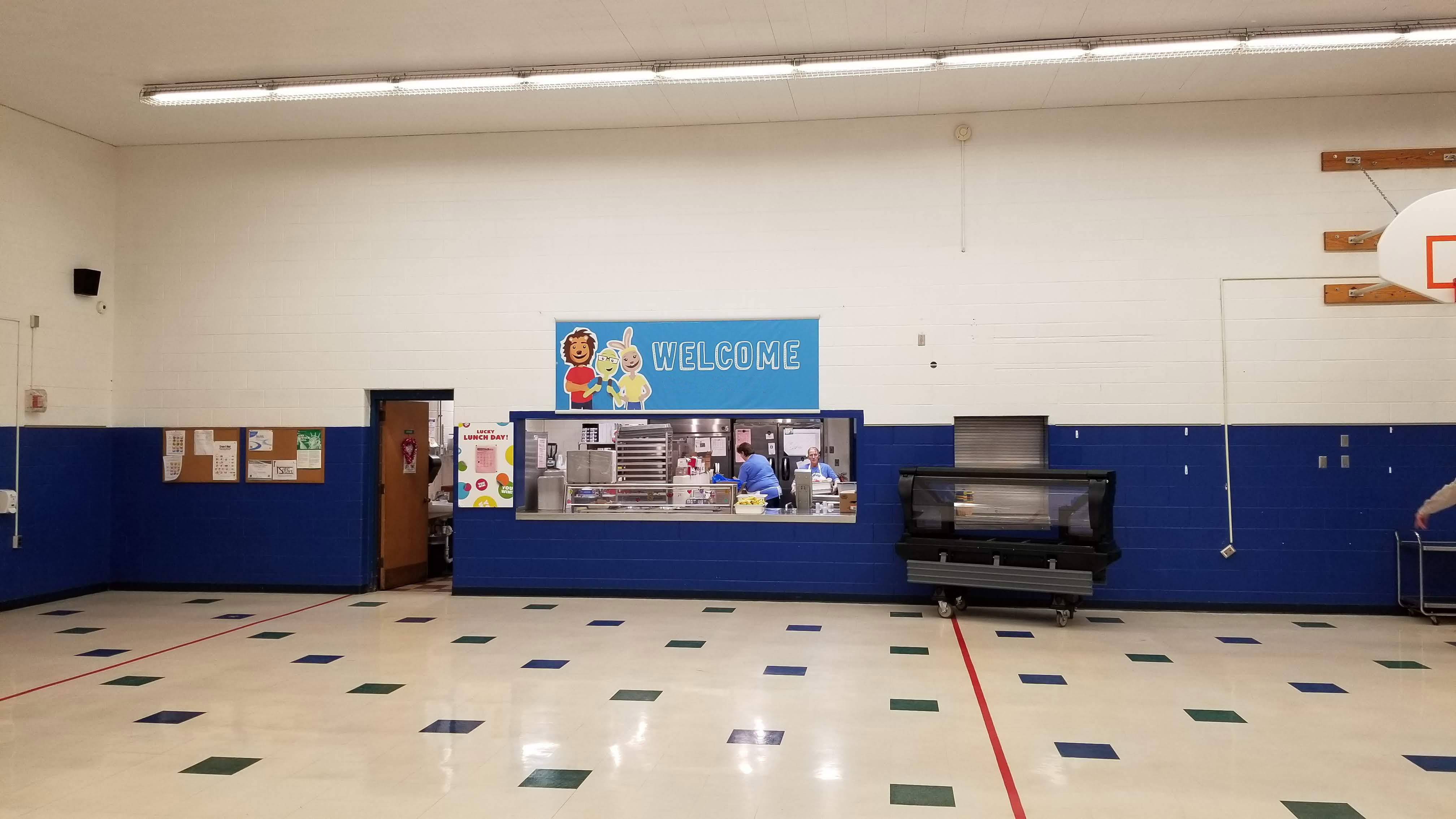

    I have a customer asking me for a 540 sq ft mural on an indoor painted cinder block wall. The Mural is 9' high and 60' wide and starts 7 ' up in the air (above door lines).
    I know I'll need a genie lift for the install and the 3m heated roller (TSA 4) looks like the best way to heat and press.
    I've watched the 3M videos on application of this material and they quote a rate of 75 sq ft per hour for the heating and rolling, but I figure the total install is probably closer to 50 sq ft per hour when you count the time to tape up the graphic, peel the backing, pat it into place and cut around objects like conduit, smoke detectors, etc.
    I'm calculating somewhere around $9 per sq ft for graphics and install but I've never done something of this scope before.
    What would you charge for a project like this?

    I'm having to do that a bunch right now (pull my pants up) because I'm 18 weeks in with a personal trainer and I'm shedding weight but I'm no where near my goal yet. If I bought new pants now I'd be buying more every 2 months so I just tighten the belt for now! :)
    This is only 1 of 3 murals they want (all roughly the same size) and they want it to look like painted brick, so textured wall vinyl it is.

    have you done any yourself, or just watching video's of someone else doing it?
    I would do a section of wall in my shop to get a gauge and not ask other what they would charge, what takes me a few minuets may to you 1/2 hr to an hour.
