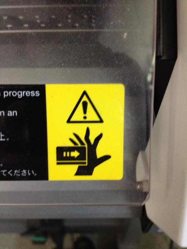

media clamps = whenever I'm dumb enough to try popping them in and "racing" the heads - and lose the race. Just about broke my wrist a while back but all I broke was the clip on the clamp
everything else= not sure....as required I guess
Ouch!!...I ruined a print head trying to race the print heads...$$$$ not fun.
That's how I found out the reason for this decal.

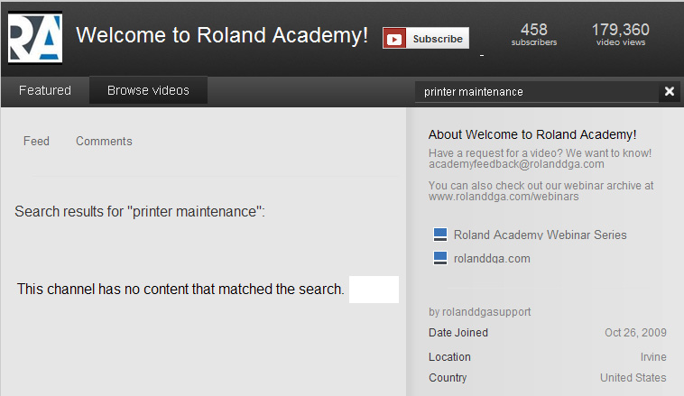

Hey Tim, I could NOT find any videos on printer maintenance on Roland TV or their YouTube channel.
On the YouTube channel, I did a search for printer maintenance, here are the results:
Search results for "printer maintenance":
This channel has no content that matched the search.
Do you have a specific link to what printer maintenance video(s) you are referring to?
