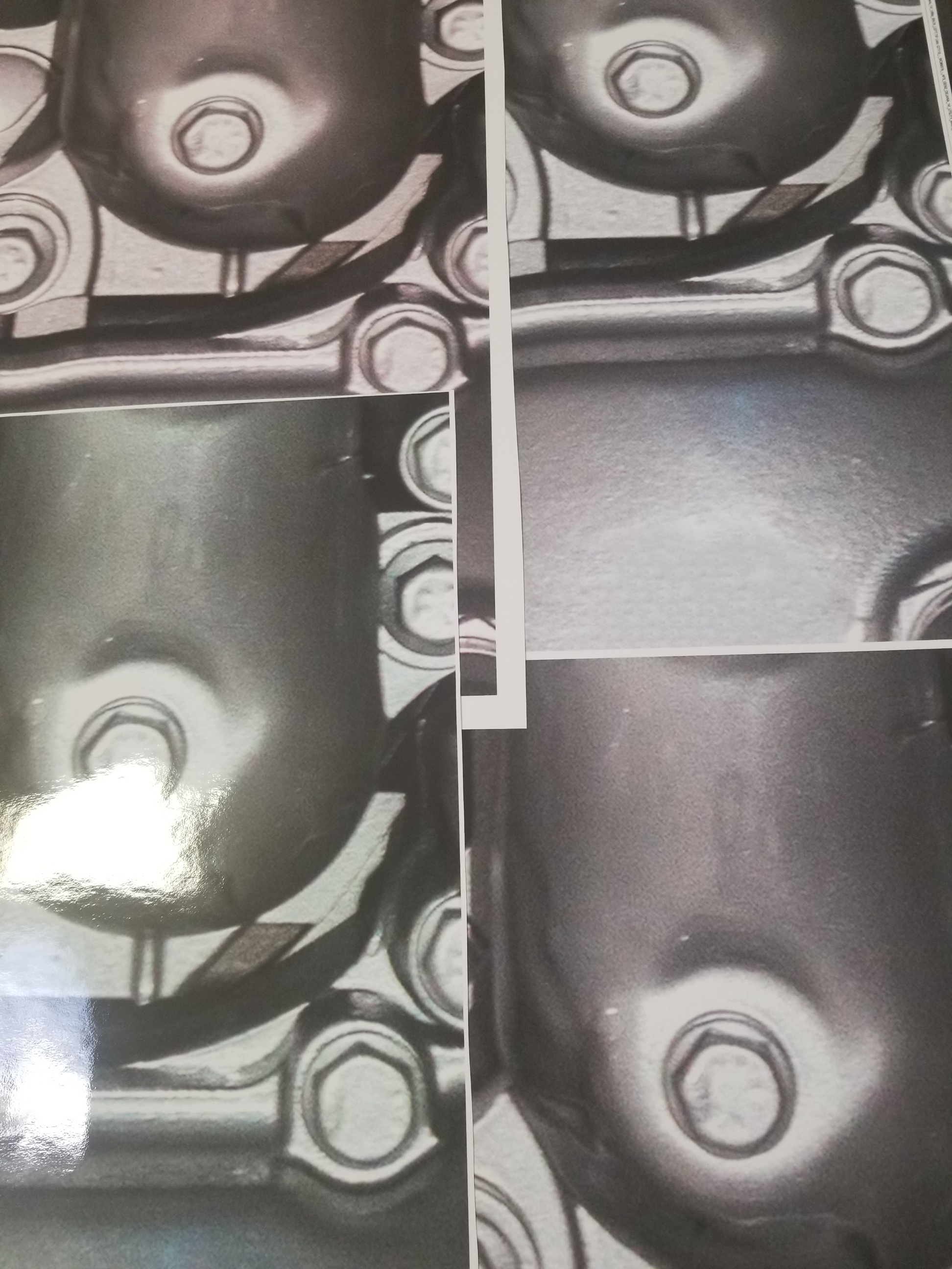

[QUOTE="2CT Media, post: 1461597, member: 17524"]Input a color in CMYK and output 4 files (1 with each intent) then do the same using a visually similar RGB... Send to your RIP with it's rendering intent settings, print and then show the result... They will be different,[/QUOTE]
Colors, yes. Not the grays in a calibrated state of the machine.
Edited to also say; The colors that do shift are normally rather extreme colors.
Edited to also say; The colors that do shift are normally rather extreme colors.[/QUOTE]
Even grey, if it is not a pure shade of black will have color shift.
I believe you're seeing the non-linearity of neutral tones between the CMYK working space vs your printer calibration / profile. If you're working space is a common RGB space such as sRGB or Adobe 1998, we know it is certainly and independently neutral, and the prints are not neutral, there is no question the machine could be better as far as calibration / profile.
No need to even make prints. In Photoshop, open something like the ONYX_Photo_Quality_Test_Lab.tif file, Convert to Profile using a common CMYK color space and toggle through the rendering intents. The neutrals will not change, except Absolute intent which is for a special purpose. Do the same with an RGB version. THEN, test previewing a conversion from those working spaces to your printer output profiles. In your case, you will see a shift in neutrals but know, you should not.

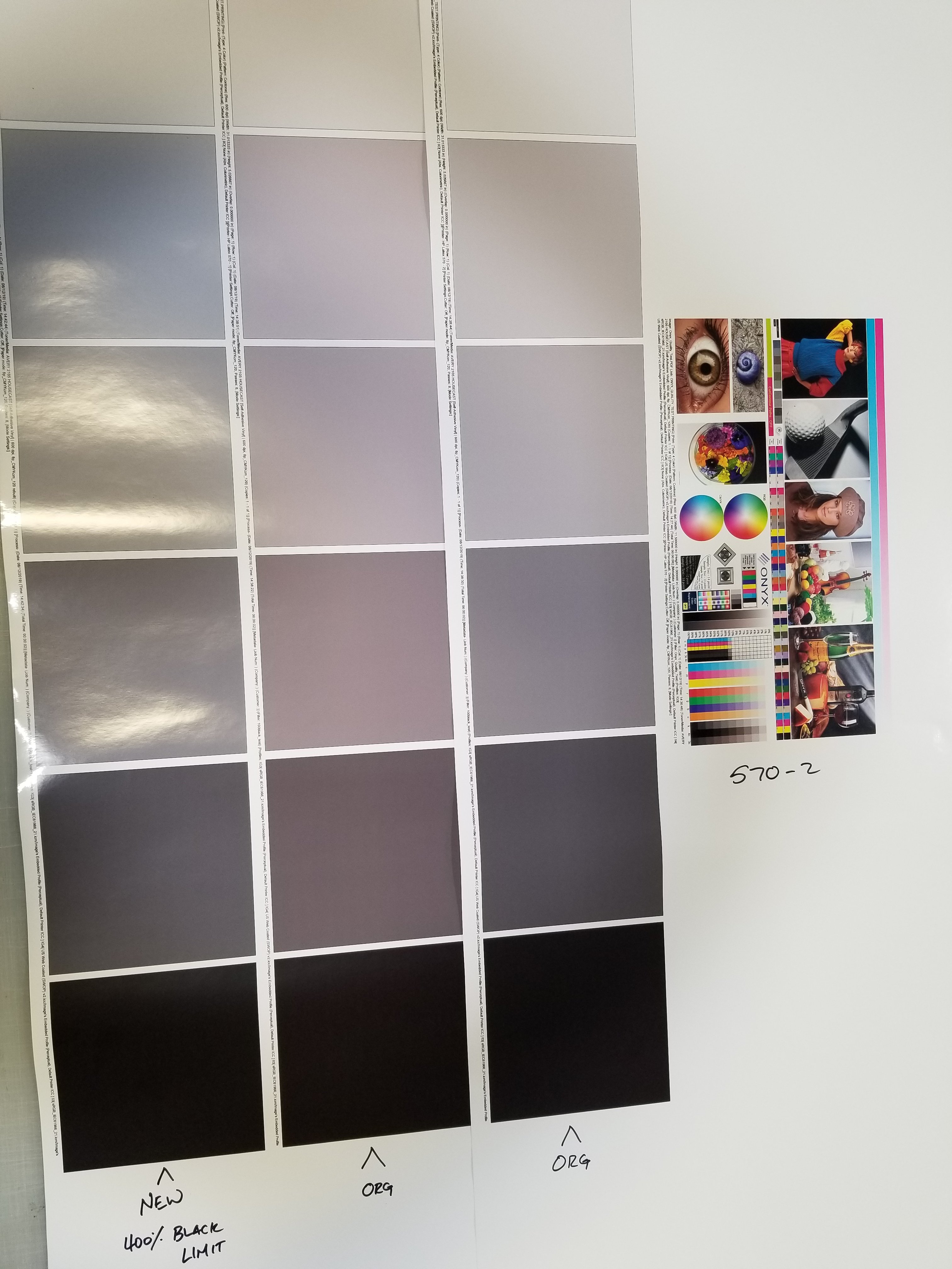

In your head I'm sure that sounds easy, but I don't do any work in Photoshop and that went straight over my head. Honestly though, this new profile put out exactly what I've been trying to achieve. Customer just approved it 10 minutes ago, so I'm happy for now.

You're not understanding. Rendering intents will not change neutrals and you've posted in #22.
But it does, I just posted pics of it. This is on a linearized custom calibrated machine. If you change intent, it changes color depending on how that intent translates to machine instruction. The only time "neutrals" shouldn't is if it is a pure hue. In his case he had a build grey which is subject to changing with different intents.
ColorCrest
All around shop helper.
But it does,
Nope. It's important for you to clear on this.
Changing rendering intents as applicable to any given image on an image-by-image basis is something production artists and photographers may do on a minute-by-minute basis and if rendering intents shifted neutrals, as you believe, the option / feature would be not be usable whatsoever.
If you trouble yourself with the exercise I've posted above, you might become a believer. Again, no prints are actually necessary because you can use the see the preview in Photoshops's Convert to Profile dialog.

Profiling a printer isn't enough! While you are profiling a printer, once you set ink restriction, you should do a G7 test! You may watch the whole performance of pr.Don Hutcheson to get a neutral gray right.
If you Caldera version doesn't support G7 test, you may use a separate software for calibration Curve4 or.... if you know how to export measurements at a certain point while profiling share the file.... I'll import the data into my application and send another one file with G7 changes. You better invite a technician who understands in color management better than you. Once you see what should be done to get it right - practice makes perfect! Eventually you will create profiles without help.
