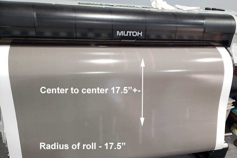

I am getting lighter strips/spots on a new roll of SV480mc. It appears to me that the roll which is stored horizontally - per 3M, may have slightly sagged in the middle over time - slightly stretching the material on the bottom side of the roll. The distance between the strips is the same as the radius of the roll. The date on the box is 05/19, Fellers shipped it to me 10/19, Just opened it up.
Anyone else run into this issue?
What is 3M's problem with vertical storage?
danno
I would recommend acquiring another roll. Provide the picture to the sales representative. I tested the 480 film before it came to market. It was great. When 3M brought it to market, I ask them why they changed it. It has been very inconsistent since it came to market.
